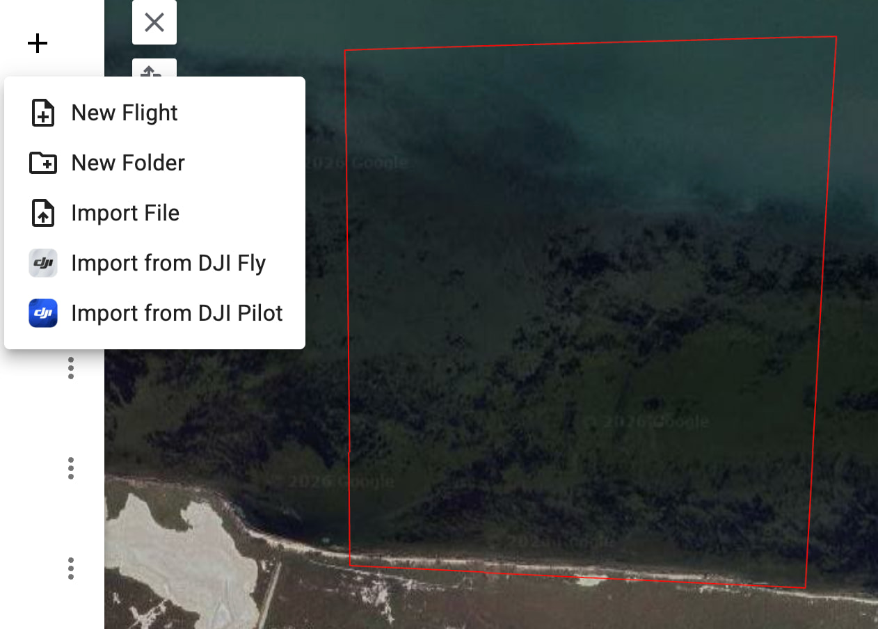

You can now export your reconnaissance flight as a KML file and reuse it for planning.
Once exported, you can re-import the same KML in two different ways in the Litchi Hub:
  • As Boundaries, to visualize the perimeter you flew and use it as a safety reference (Import File).

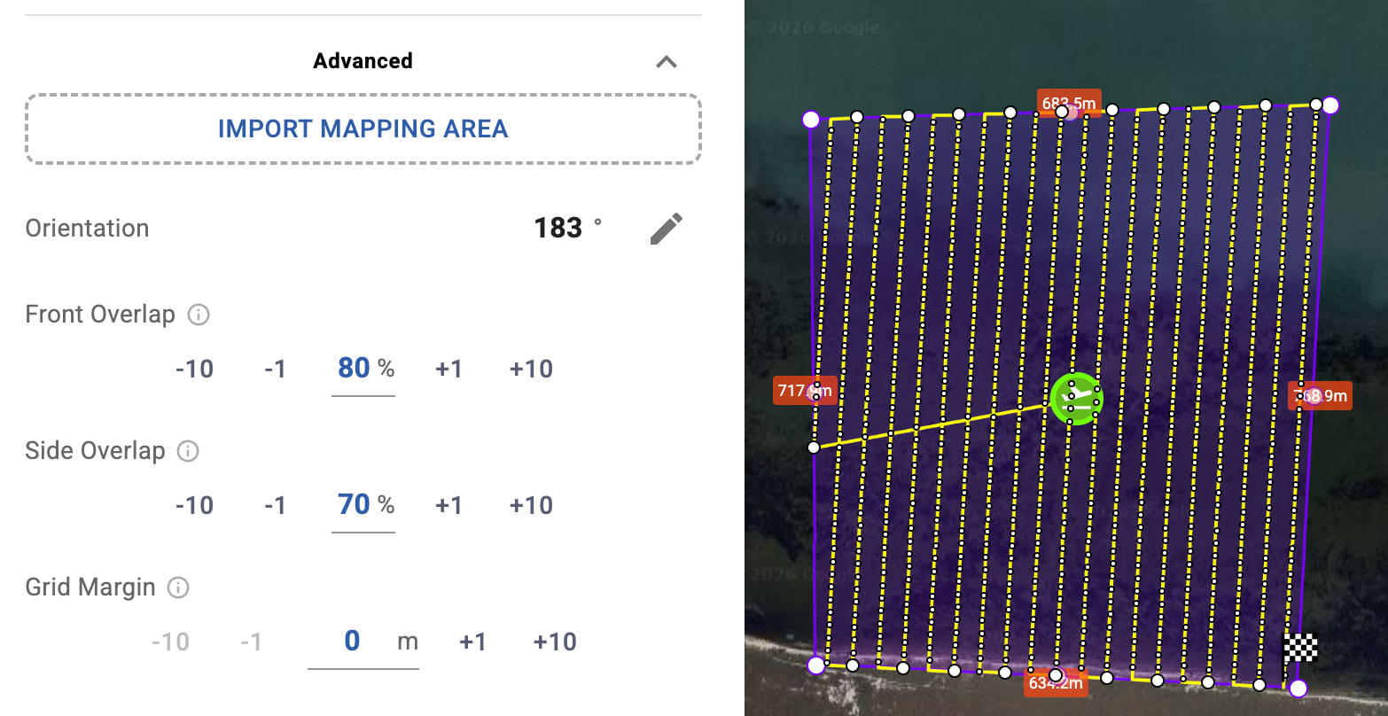

  • Directly as a Mapping Polygon, by importing the KML into a Mapping Flight advanced settings (Import Mapping Area).The polygon will be generated automatically from the KML shape.
This allows you to first fly the perimeter with waypoint markers, export the flight as KML, and then reuse that exact shape on your PC to create the mapping flight while keeping your safe boundaries.
So the workflow is essentially:
  1. Fly the reconnaissance flight and mark the perimeter.
  2. Export the flight as KML
  3. Import the same KML into the Hub.
  4. Use it either as Boundaries or as the Mapping Polygon for a mapping flight.
This makes it much easier to convert a reconnaissance flight into a proper mapping flight while keeping the exact limits of the property.
