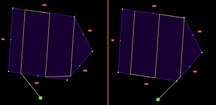

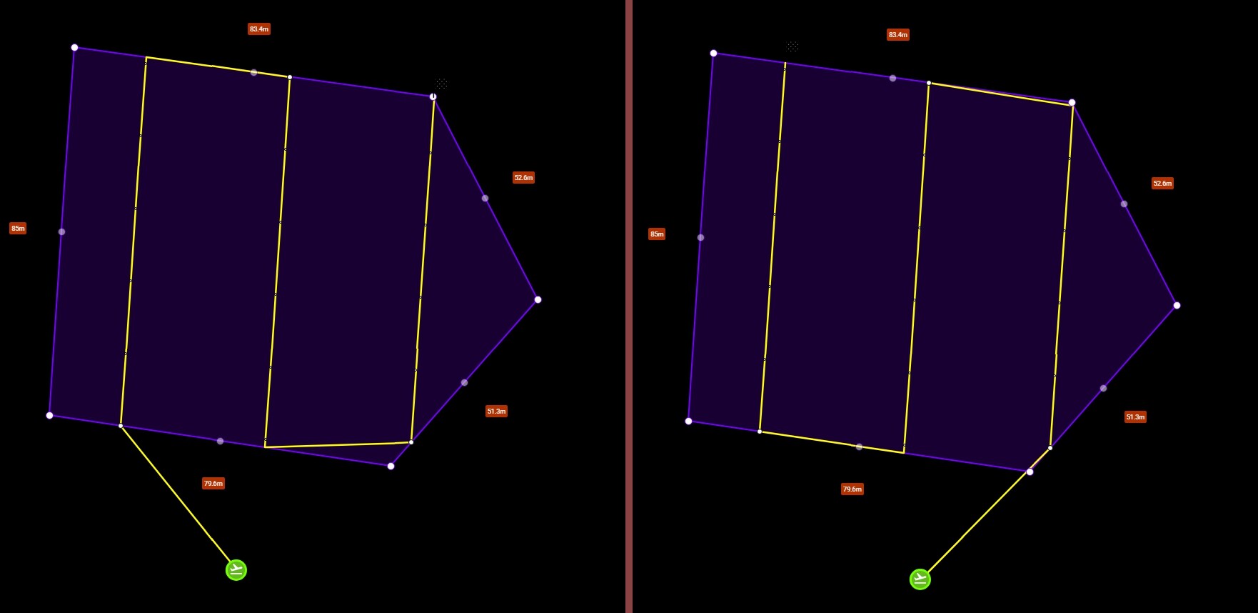

The home point in mapping missions is used to determine roughly what the ground elevation will be at the take-off location. If your mapping mission area is relatively flat, the exact take-off location will be less important. If your mapping mission area is relatively hilly, it will be important to select a take-off location that is at roughly the same elevation as the location chosen when planning the flight. You can see the effect of moving the home point location by planning and previewing a mapping mission in 3D in the new Mission Hub. When the home point is moved to a higher or lower elevation, the height of the mapping mission will change.

No it does not.
But it can change the first point of the Mapping Area the drone flies to

Just like to add that the take-off pin, (starting point) you placed during any plans setup is a starting point of reference. So taking off a few feet or even 30’ or so from where you placed it originally won’t affect the actual mission as long as the area is relatively flat. I believe Tribar explained it well. If needed you can easily move the reference pin closer to the actual take-off area while at the location. Of course this is only if it will make a difference based on what you see at the actual location.
