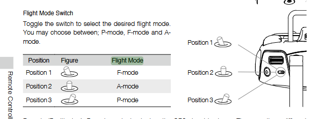

Although your screenshot indicates that the drone is in “P-GPS” mode, I have to ask if your flight switch is in “P” mode. If it is not, you will get that error message:
I would also check your drone has the latest firmware update.
My aircraft has the latest firmware version and the controller is in P mode physically.

UPDATE: Phantom 3 Professional should be in F-Mode note in P-Mode for uploading and fly a mission.
Found it here, tried it , worked. Litchi Waypoints ~ Control Problem | DJI Phantom Drone Forum

You are correct. These older DJI drones called it F-Mode. I have a Phantom 3 Standard and always have it in that mode despite the fact that I forgot they called it F-Mode back then.
