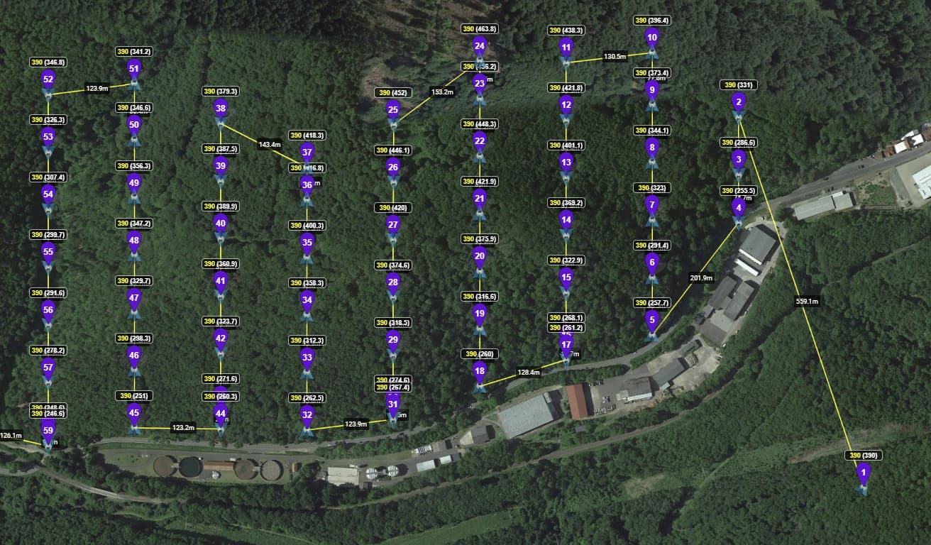

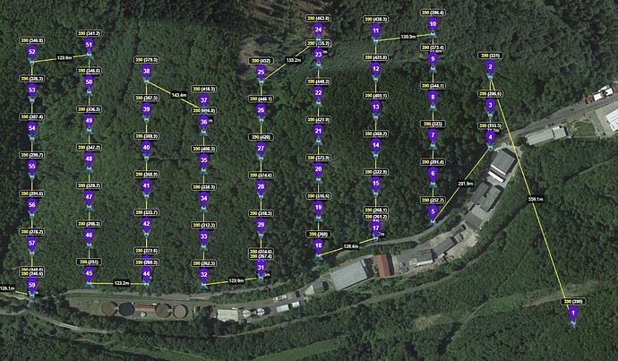

So well i make up a quick 80/80 overlapping Mission to explain at a screenshot.
So just for theory. I made up a Test Mission with bigger diffrences in Elevation. Which would be quite normal in a hilly area.
lets say you start at WP 1. Which ist just for practice Z=0 Drone will fly 390 above Z=0 at WP 1 and all following waypoints relative to this. This will work out fine for the pre calculated Overlap. So you fly till maybe WP 24. Connection gets bad. Stop Mission. Make your Way by car to lets say WP 32. Restart Drone and Mission at WP 32 (e.g.because of a better connection) now you are about 130m deeper than at WP 1. Starting on the grond below WP 32 your Z will be about -130. If you would fly the next 25 Waypoints from here now, lets say flying at Waypoint 26 where you should be at 446m above WP 1 in theory you would only be at 446-130=316m above Waypoint one because the height ist calculated from starting Position which is now at the ground under WP 32.So now the drone is 390m above ground height at Waypoint 32 but only 260m above starting height at Waypoint one height.
So this is what i think happens. This of course affects the Overlapping drastically if i am right.
So the question ist if it would be implementable to calculate Mission height always the way it is planned / or at least have the option to do so (of course in the 500m limit). Since litchie knows the Z-Values from calculating anyway it would just have to add/sub the difference at the actual starting point to keep the overlapping properly adjusted. This would probably help a lot of people to do better mapping in hilly areas.
The same by the Way, maybe even worse should happen when mapping in urban areas. Starting on a rooftop or on the Street (because the plans change all the time, when you are “out for the job”) will make a huge difference, especially flying as low as you are mapping buildings with low GSD. Having 5-10 m height diffrence should make even an bigger impact on overlapping when only flying at 60m for example.
