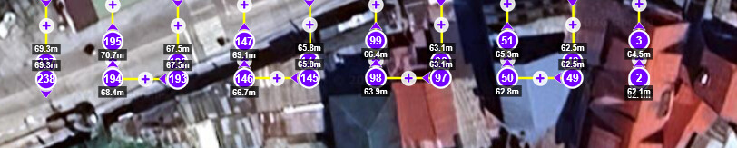

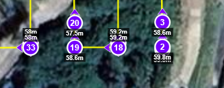

Screenshot as example:

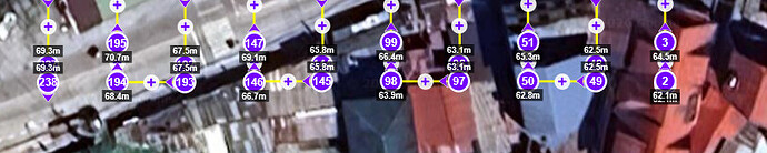

look how close some of these waypoints are.
33 and 32 both have 58m and <1m apart
1 and 2 both 59.8m and <1m apart
17 and 18 both 59.2m and <1m apart
is that absolutely necessary to generate the waypoints like that?
just keep the 1, 18 and 33 (the most outer) and remove the other which are unnecessary if you ask me.
And I mean, it’s not a big issue of course - but I have the experience the lesser waypoints the better, more responsive the controller is.
I’ll illuminate the step by step I’m doing.

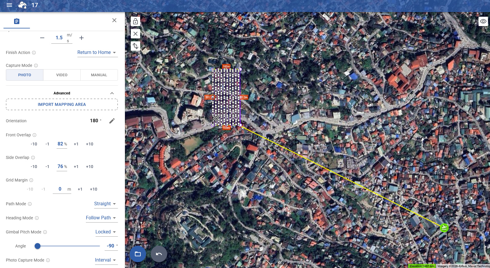

I first import a polygon exported from QGIS using the “IMPORT MAPPING AREA” option
Now I export that to KMZ
I import it back - so I can get the individual waypoint planning interface available for manual adjustment of individual waypoints (cranes, high buildings, power lines, and everything else that warrants manual adjustments to certain waypoints)

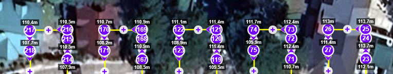

At the edges I now get the ‘unnecessary duplicates"‘

Maybe I should rephrase what I want to achieve, I wish to achieve that waypoints which have no value to the actual flight planning not the be generated.
The flights are planned as “interval” for photo shooting. Not as 1 photo per waypoint.
For such a flight plan, a waypoint identical to the waypoint next to it in elevation and just 1m apart is of no value for mission planning for area survey.
Though even as 1 photo per waypoint, it wouldn’t make any sense as the overlap would be 97% or 98% and that’s just unreasonable.
Further, these waypoints are so close to each other, zooming in at max level, even then one can’t distinguish between them, that’s how close they are.
And thus, it’s unreasonable for one more reason to have them being generated
A further observation I made for the unnecessary, unreasonable close to each other waypoints - they are happening ONLY before a turn after a “longer” straight flight, but NOT ALWAYS. Sometimes they’re not being generated especially for straight flight paths <100m they’re not always there.
For straight flight paths 200m I witness them ALWAYS being generated.
So maybe it has something to do with the “Smooth curves” setting..
But I clearly set my path mode always to “Straight” I don’t want smooth curves.
So with the setting “straight” they shouldn’t exist.

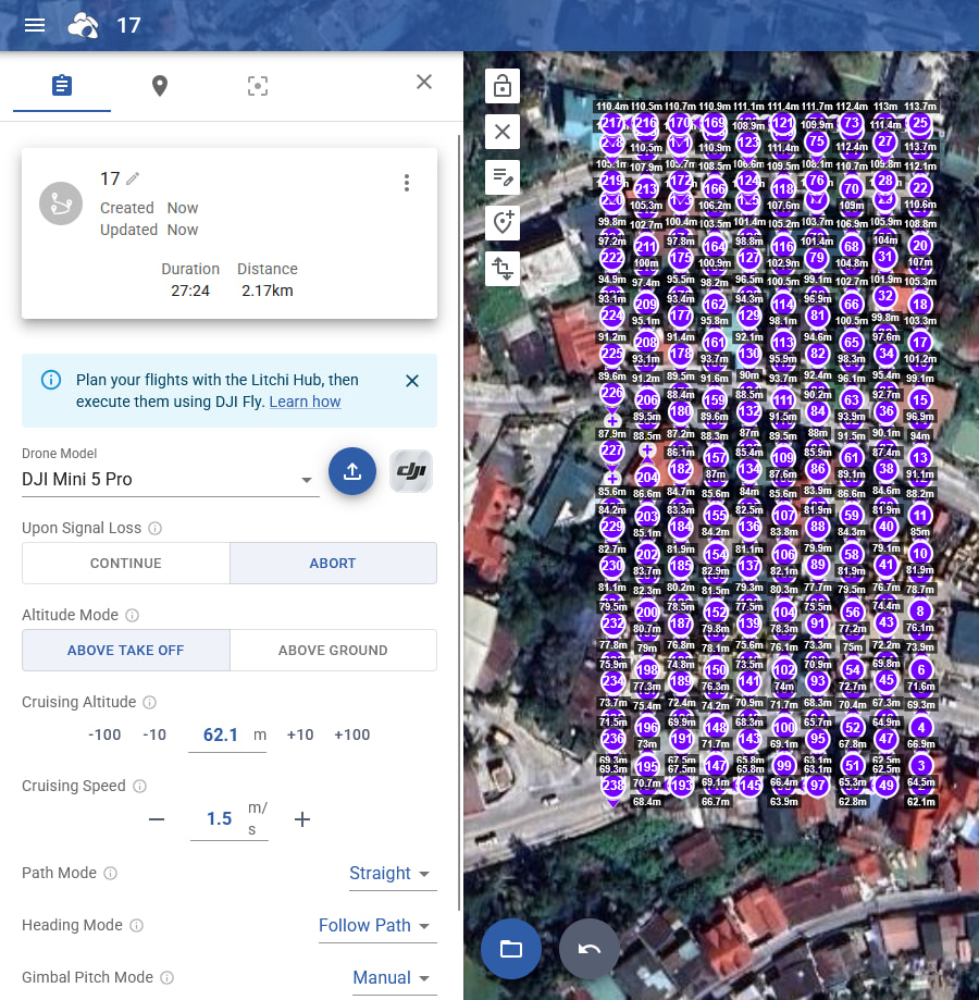

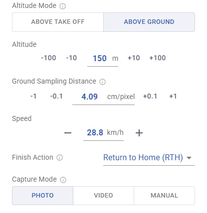

I create an Area Mapping Above Ground and choose all the modes to see, wich of them creates less WPs.
I exported as KMZ all the possibilities and import to WayPoint Mission
The result:
Video 16:51 - min - 337 WP
Manual 16:51 - min - 337 WP
Photo WP action - 15:58 min - 221 WP
Photo WP auto - 15:58 min - 221 WP
Photo WP interval - 15:57 min - 156 WP
The less WPs, the quicker the mission.
