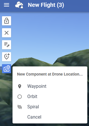

Before Aim Point, it was much easier to plan a mission. In Google Earth view, you just had to choose a viewing angle and click the camera button on the left, and the hub would create a Work Plan (WP) at that angle.
Now you have to use the 2D view to adjust the drone’s position, and that button creates a WP at the drone’s current location. And you must go to Google Earth to try to ajust it by entering numeric values.
It would be better to revert to the previous version, or give the option to turn off Aim Point.

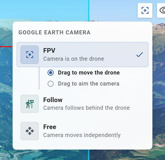

We’ve added a new submode for FPV mode.
By default it is set to ‘Drag to move the drone’ which means if you drag the mouse it moves the drone instead of the heading/tilt.
Aim Point is a 2d map feature, it does not affect the google earth view
Thank you so much, now it’s working as I needed it to . Yesterday the hub was stuck in AIM mode, even in GE mode; using the mouse scroll wheel only increased the zoom.
With this new subitem set as “move the drone” it is much easier.
