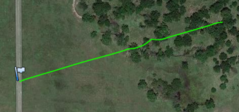

The flight:

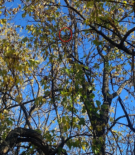

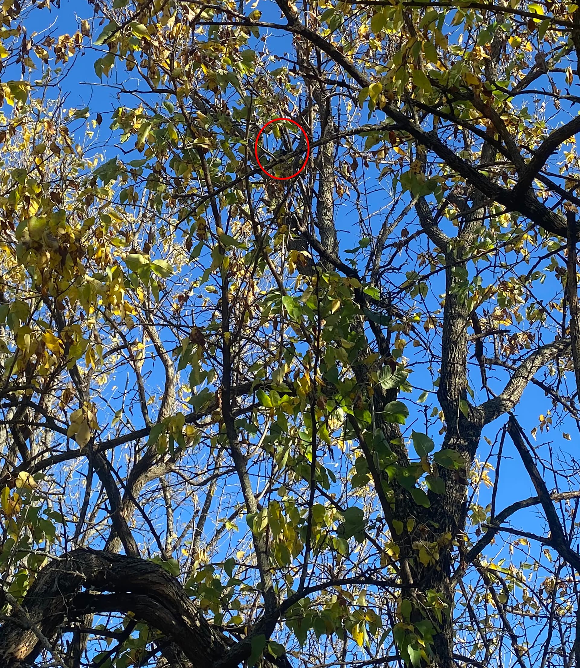

The result:

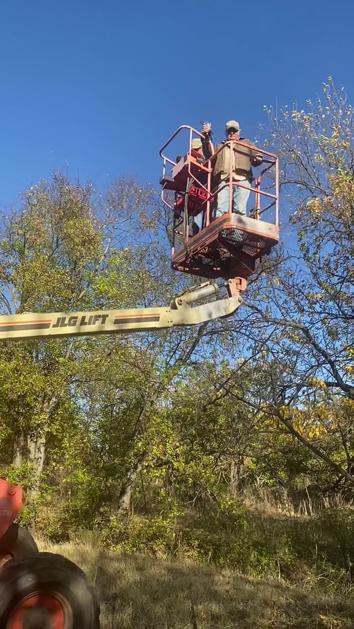

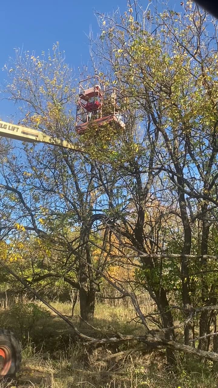

Recovery team:
Almost there:

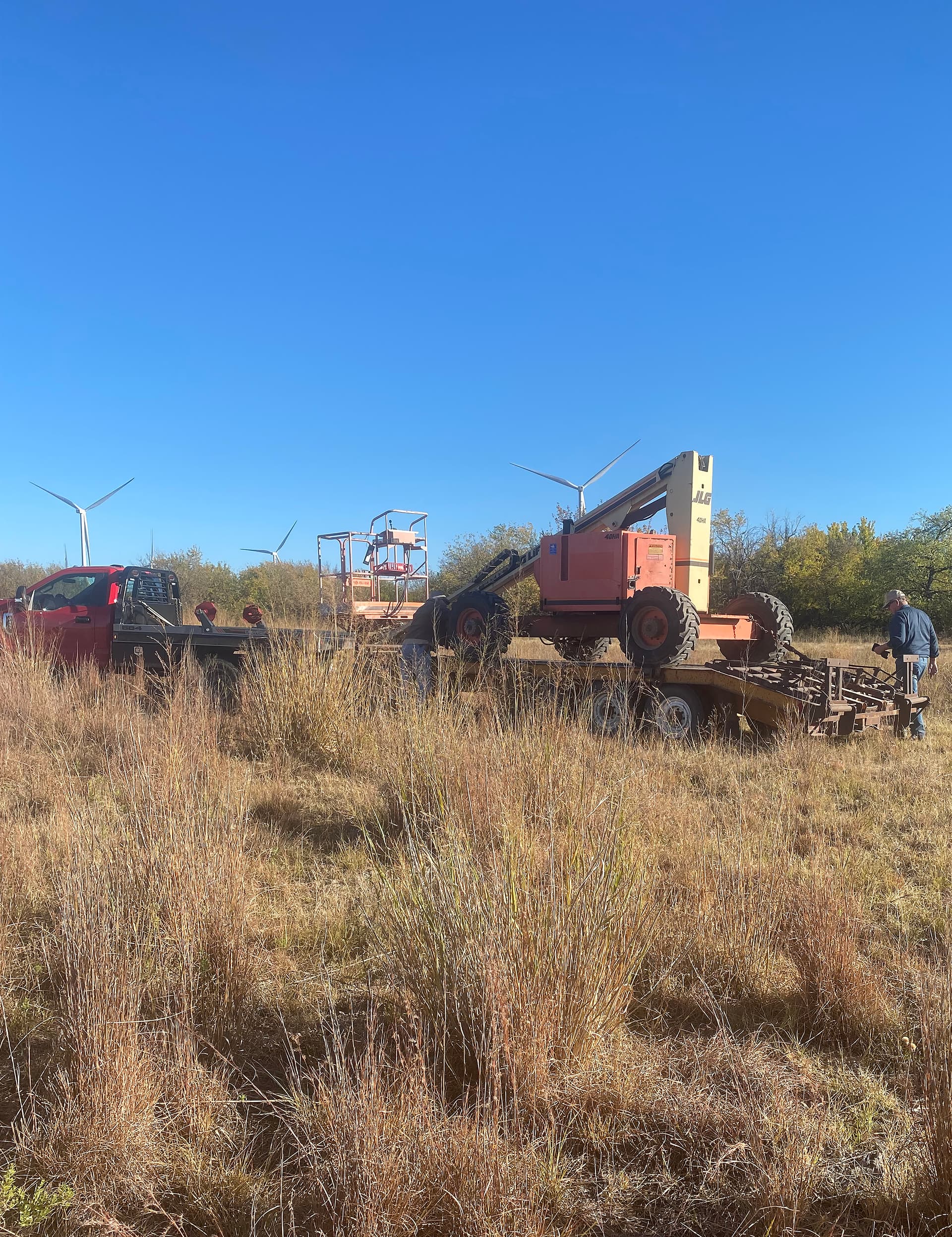

Got it:

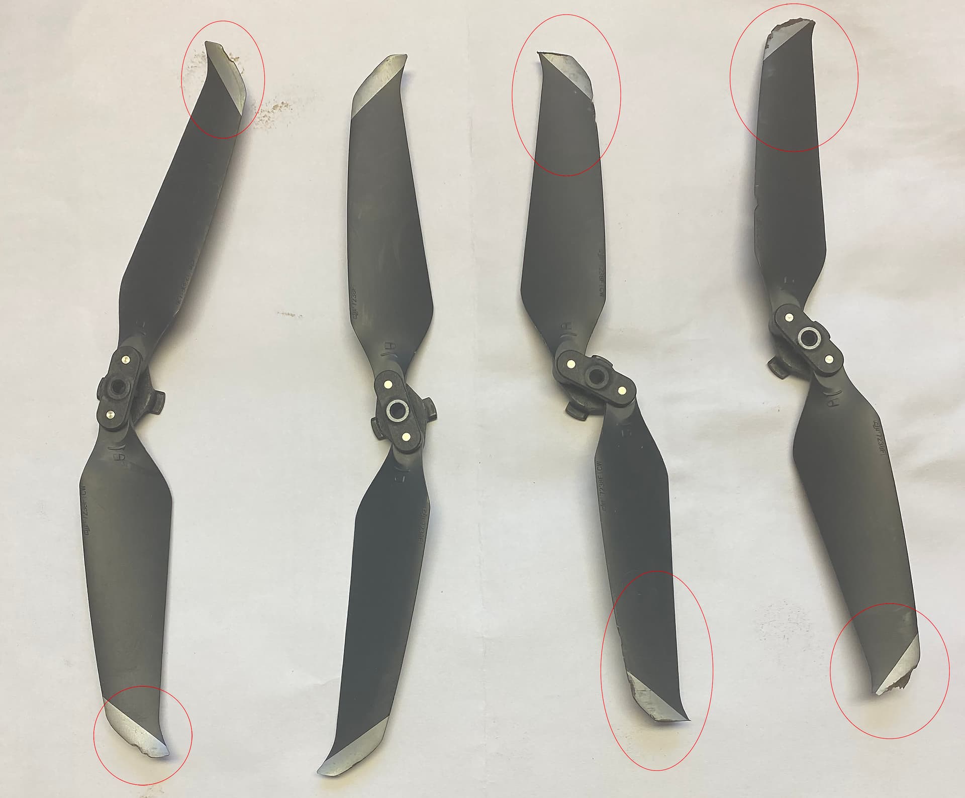

Damage report:

The drone was still on-line after impact and communicating with my smart controller. Other than navigating terrain, finding it was piece of cake

Good neighbors and family are definitely an asset. I normally have at least two preparatory waypoints at the start of a mission but this time not.
I used two in-house Excel based programs to create the mission.
One to generate the grid search pattern. And another which adds pre and post waypoints to any Litchi mission.
I use wp-1 to bring the aircraft up to a low altitude so I an check it is operating properly and wp-2 to take it to a safe altitude and avoid an obstacles in the immediate launch area. This time, I didn’t set wp-2. Lesson learned.
