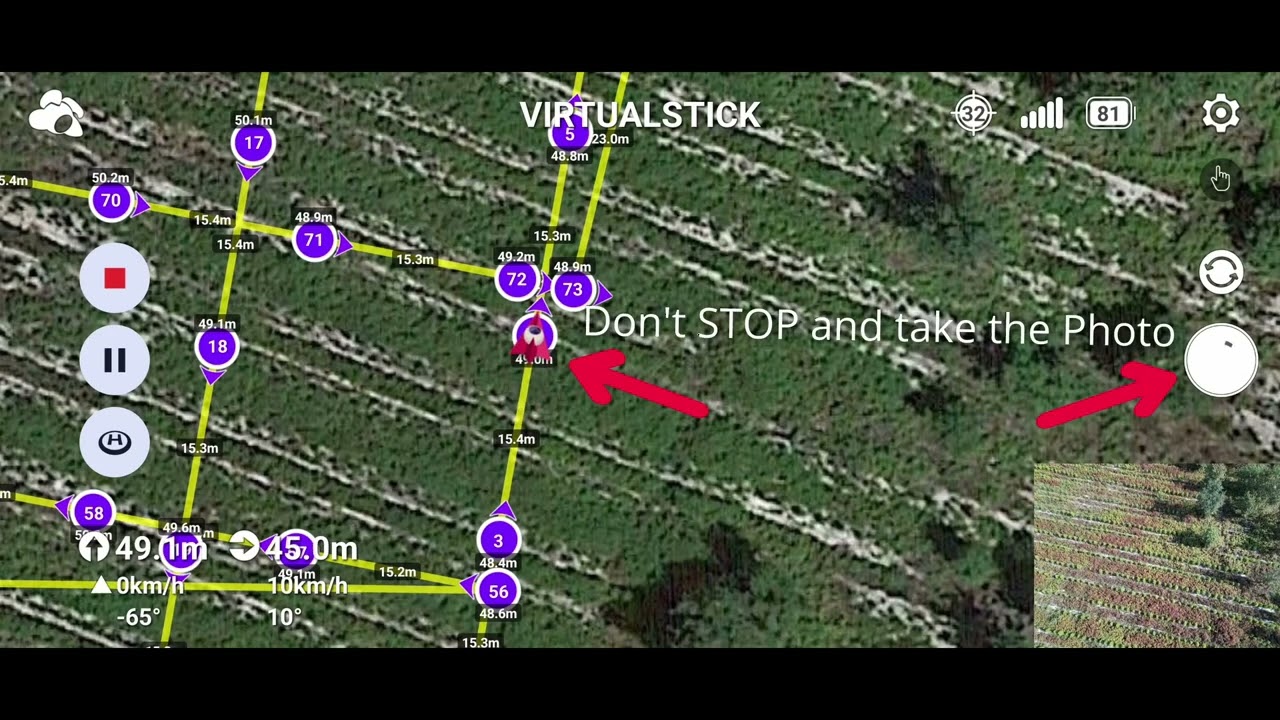

You’re absolutely right, I’ve done lots of tests and in fact at each waypoint it still takes a photo.
Ok it doesn’t stop when setting in ‘Curved Turns’.
What I do is to set interval greater than the maximum length.
For example, if I make a mapping (I always x2 with 90° for grid) for Mini 3 Pro 30x20 I set interval to 32 and so I just have ONE photo at each waypoint (it has no time to take another one before WP) and it works (will do a video).
And we have a ‘terrain follow’.
