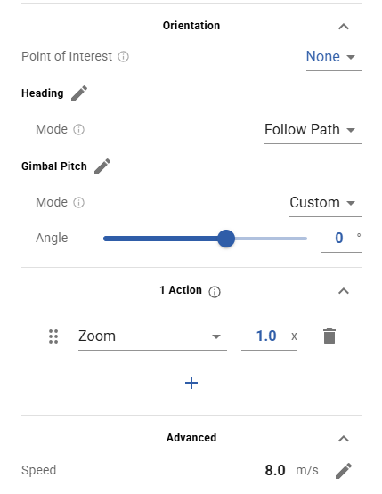

You can add a Waypoint Action “Zoom”.
I don’t know if this will change the active camera used.
Thanks yes saw that im not sure if it will change it to the 3x zoom camera i will need to go out and test this.
If you set a zoom action to 3x it should change the camera. Do report back!

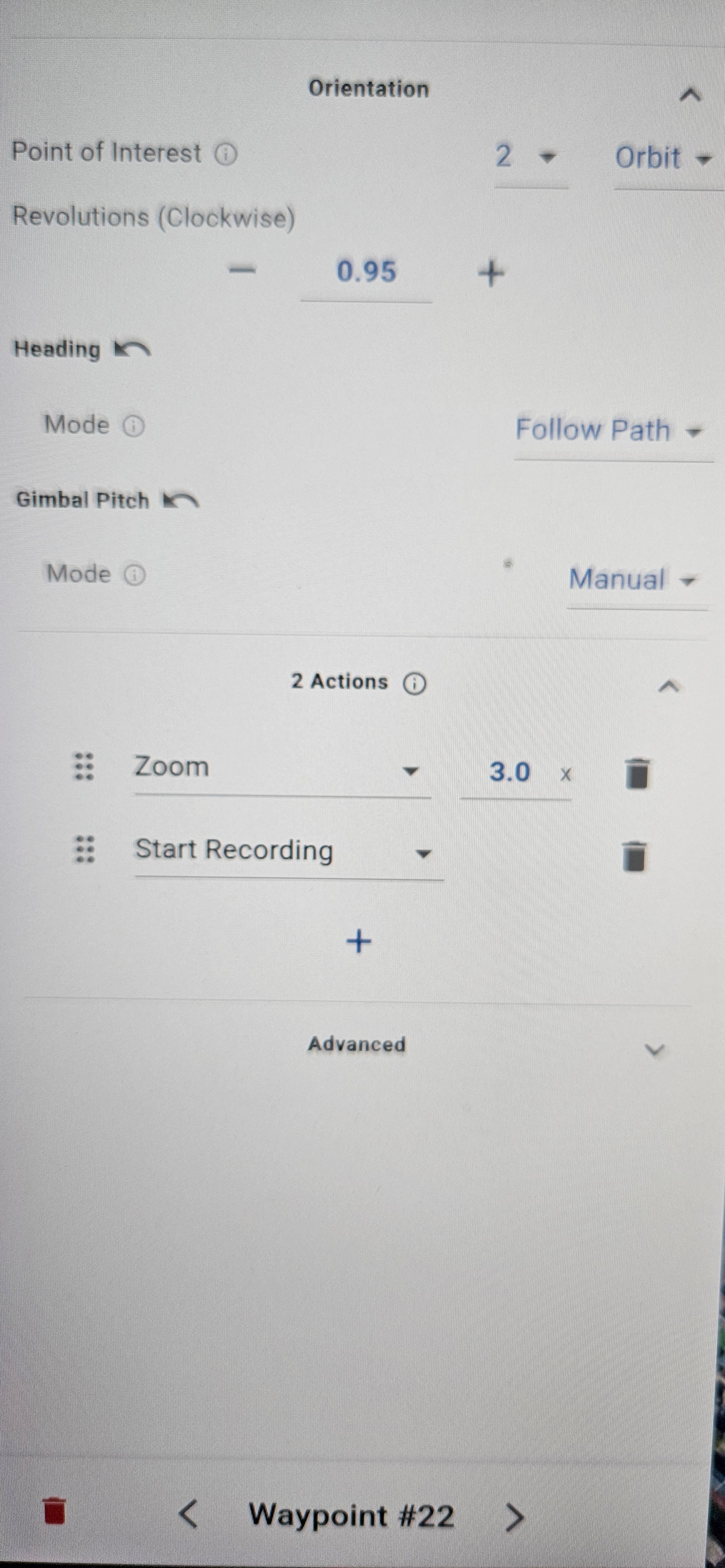

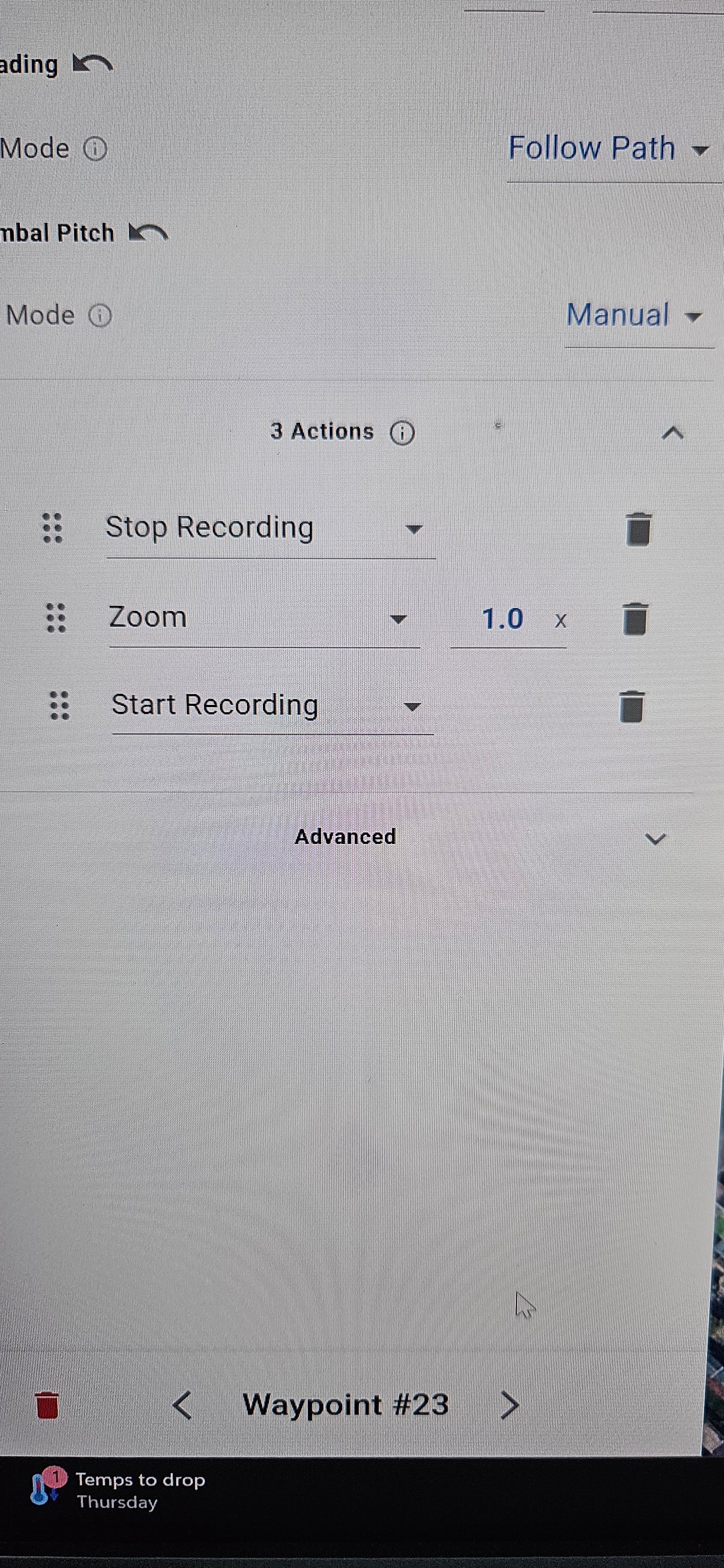

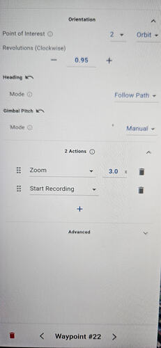

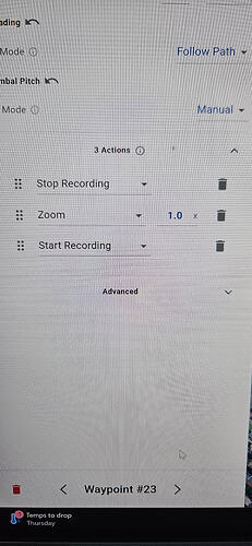

Ok did several test flights and it did not switch the camera zoom at all i double checked the flights and the actions all looked good but no joy . Air3s .
tried that today no joy

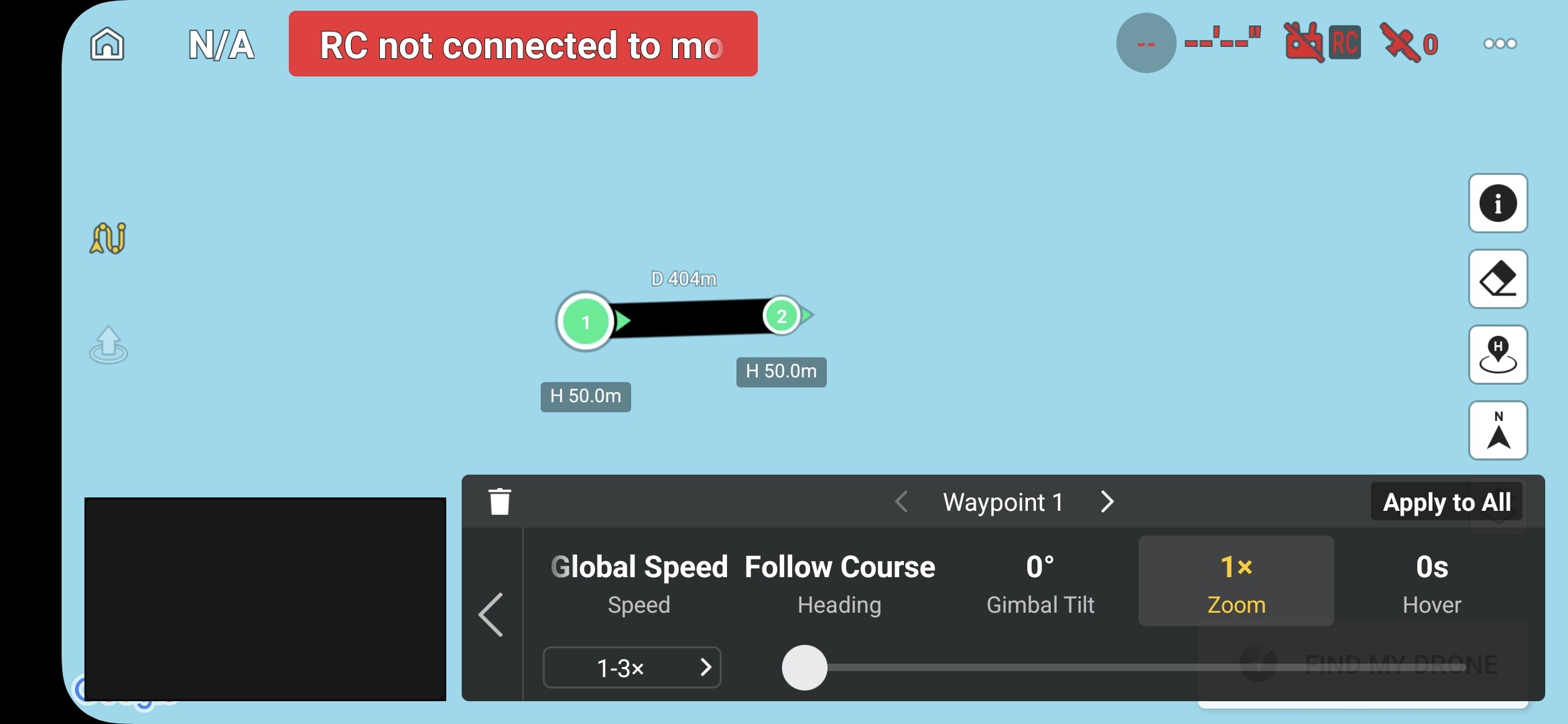

You can only have 1 camera action per waypoint when using DJI Fly.
Check the mission on your flying device after transfer from the Hub, in DJI Fly Camera Action & Zoom are 2 different entities.
no option in the dji waypoint planner that i can see 3x zoom
