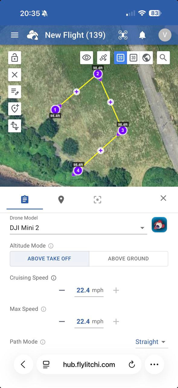

The settings screen for the new hub now shows 33.6 mph for both the max and cruising speeds (as has it always been for the settings in the old hub). And the new hub now allows me to set the speed to 33.6 mph at any waypoint, and those speeds are also reflected in a simulated run. But, as you have pointed out and DJI confirms on its website, the actual max speed for normal mode is 22.4 mph. I just confirmed this behavior in an actual waypoint flight in sustained winds of 25 mph, gusting to 35 mph (as it was reported by my nearby weather station, and yes, the flight was very scary!). I think it would be far less confusing if the settings tab limited speeds to 22.4 for both max and crusing speeds, because that’s what happens during a Litchi mission.
Could you please provide a screenshot of the issue you’re experiencing?
My error. I had not selected the drone model to Mini 2, sorry
