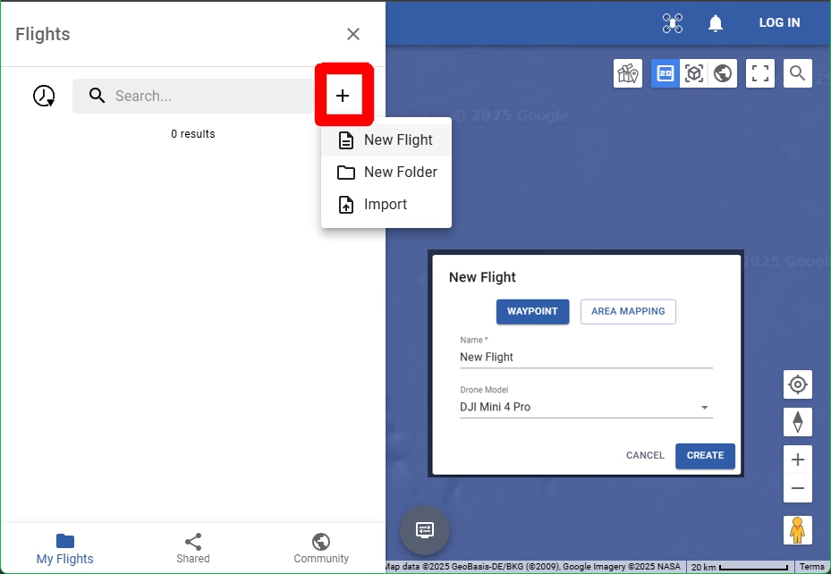

Did you use the old (/flylitchi.com/hub) or new (/hub.flylitchi.com/) Mission Hub ?
In the new Mission Hub:
There’s NO Save command.

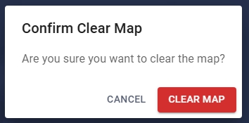

Clearing the Map does NOT create a new Mission (Flight Plan), it deletes all WP & POI in the current Flight Plan.
You have to use the “New Flight” command to create a new Mission (Flight Plan).

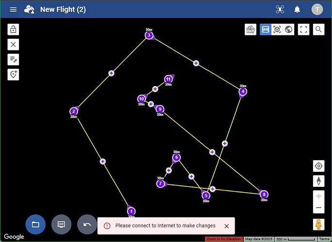

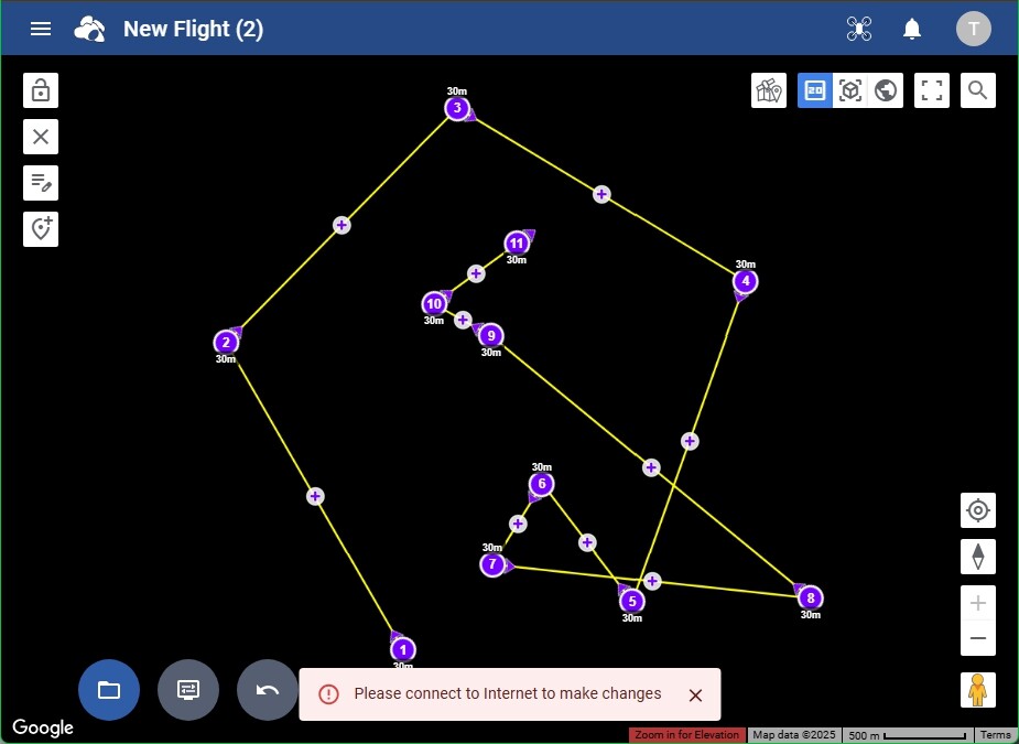

If the problem is due to an intermittent network connection, it would be difficult to replicate.
The new Mission Hub gives a warning when there’s no internet connection:
