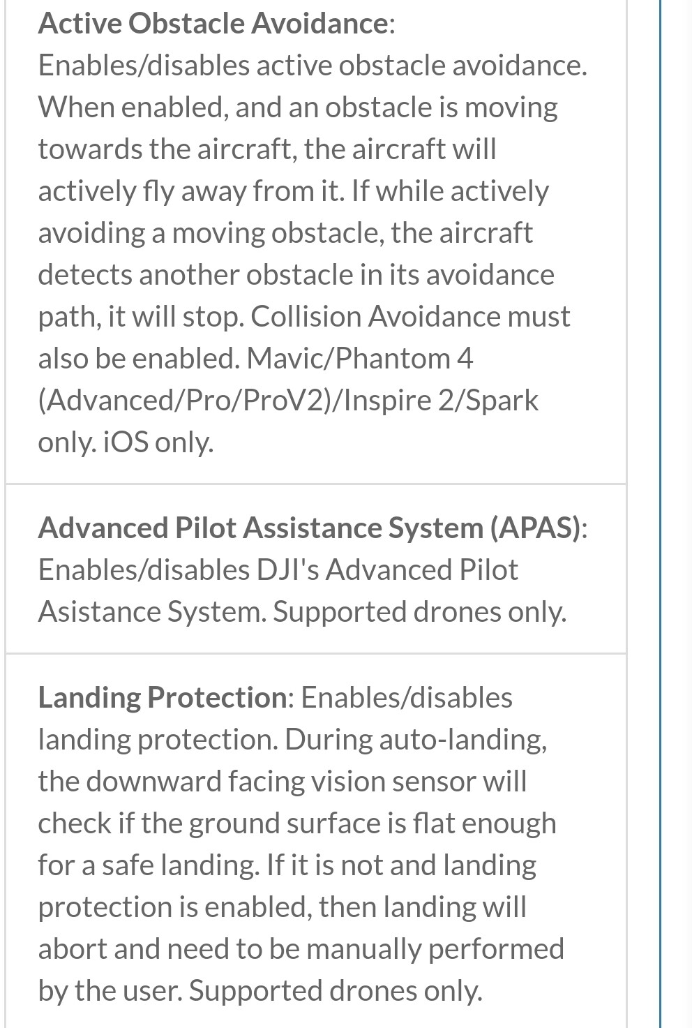

The Screenshot does not have some options in it after Signal Loss Behaviour that are in the guide such as:-
Smart Return to Home: <<< Is this inherited from DJIFly??
Exit Waypoint Mission on Signal Loss
Collision Avoidance <<< I get that - Mini SE does not have collision avoidance
Disable Sideways Flight <<< as above
Active Obstacle Avoidance <<< as above
Advanced Pilot Assistance System (APAS) , Not in my drone
There are more items missing as you can see.

The user guide describes a setting " Smart Return to Home: Enables/disables the Smart Return-To-Home (RTH) feature. When it is enabled, aircraft will request to go home when remaining battery is only enough for completing the go-home action."
This then (if I have this correct) is what @wesbarris has said is really “Low Battery RTH” and is a calculation done by the drone itself.
I can’t help wondering why there is “Smart Return to Home” setting if this is all automatic,

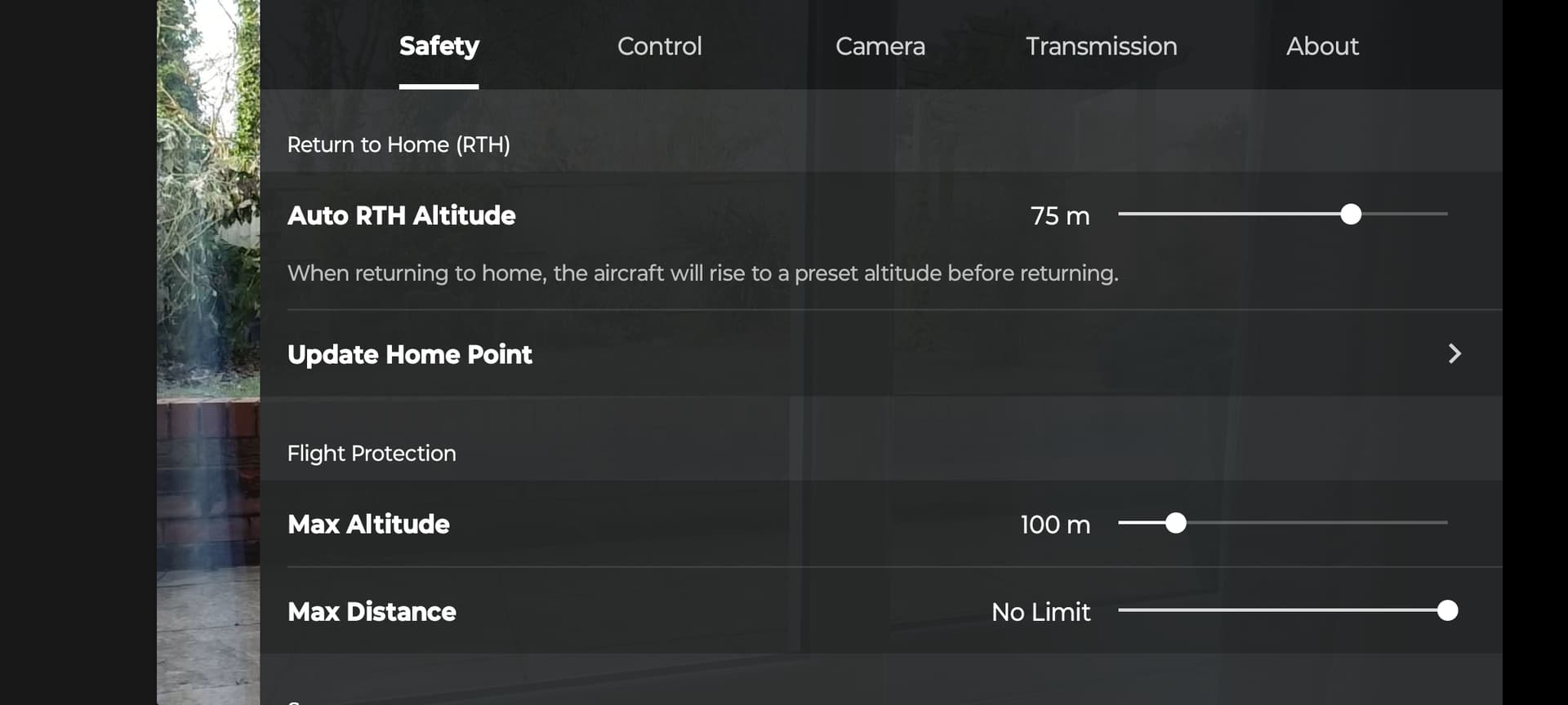

With regard to RTH, the first screenshot shows the DJIFly app setting …which you can only get to with a connected drone (note the garden wall in the background as evidence of a connected drone)
I set the RTH altitude to 75m (was previously 50m) and closed the DJIFlyapp and then Forced Stop it.

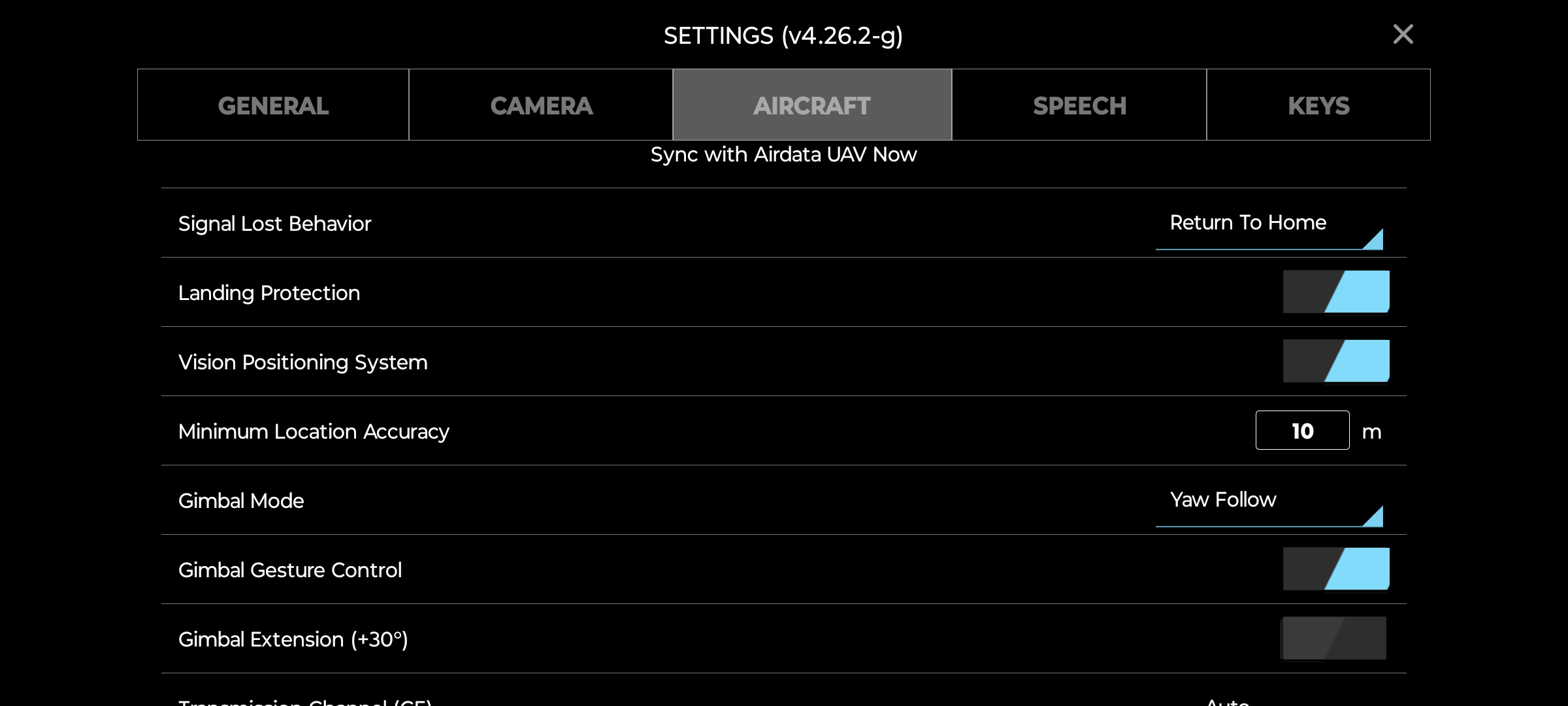

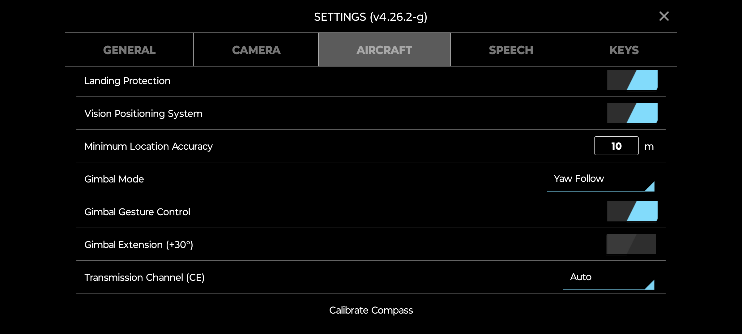

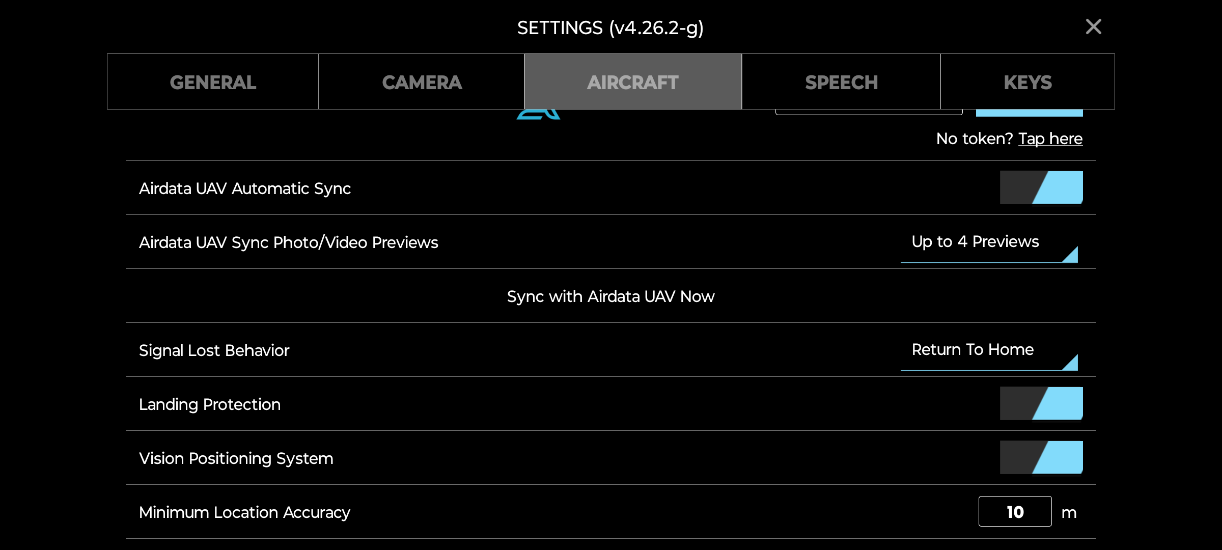

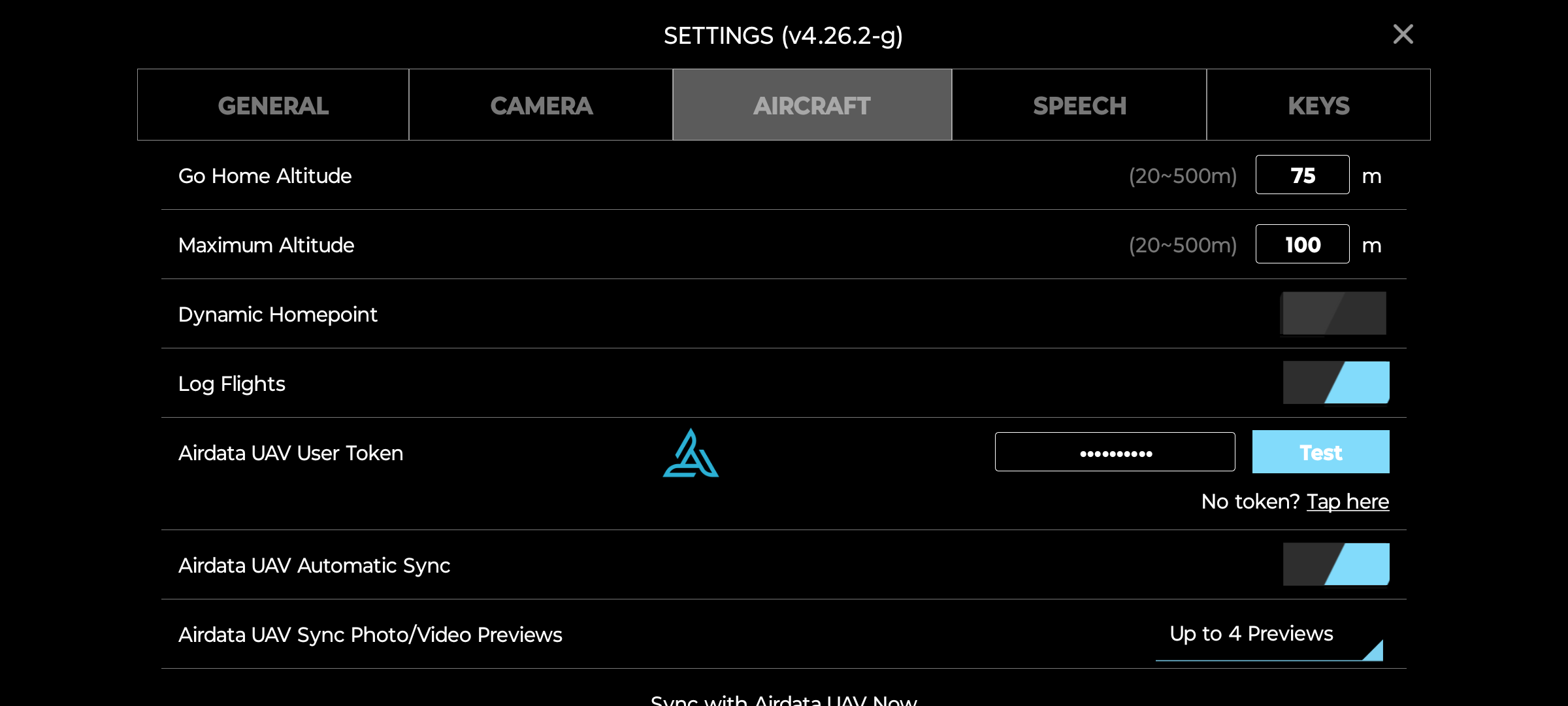

I started Litchi and went to the Aircraft settings. The following 3 screenshots show the entire list of settings available to me.
My original question was centred on why the set of settings above is different from the User Guide and whether RTH due to low battery would still work.
From the the posts above, it seems that the list of settings is a reduced set from the User Guide because the missing ones are not applicable to this drone.
RTH altitude and signal loss behaviour are the only RTH settings available (see screenshots) in this because of the type of drone.
