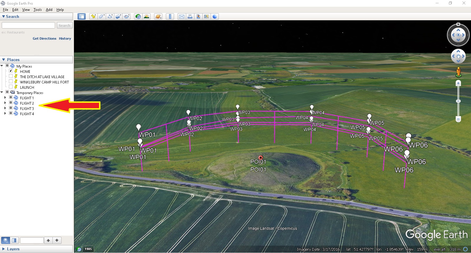

Hi Fulvio,
Do you mean like this ?
Turn off or delete flight 1, 2, and flight 3 in Google earth places to show your most recent flight.

Hi Fulvio,
I understand your problem now, this would be in the mission hub.
Good that you have found the answer !
