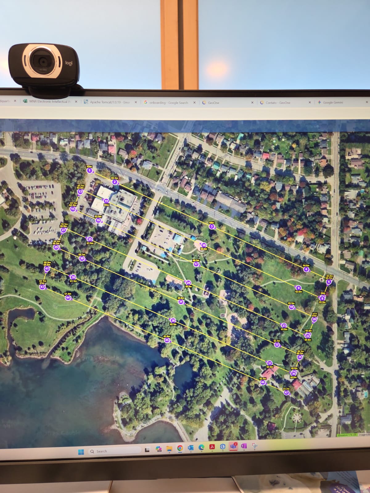

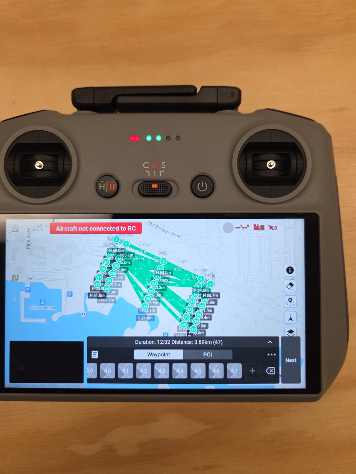

When I upload my flight to my RC2, the flight lines appears as a zig-zag pattern. See the pictures below:
On the flight simulation online it seems ok.

This is a result of DJI’s partial support of straight line missions. Your mapping mission will execute properly. It is only DJI’s display that is wonky.
Thank you! That was very helpful. My flight was perfect.
