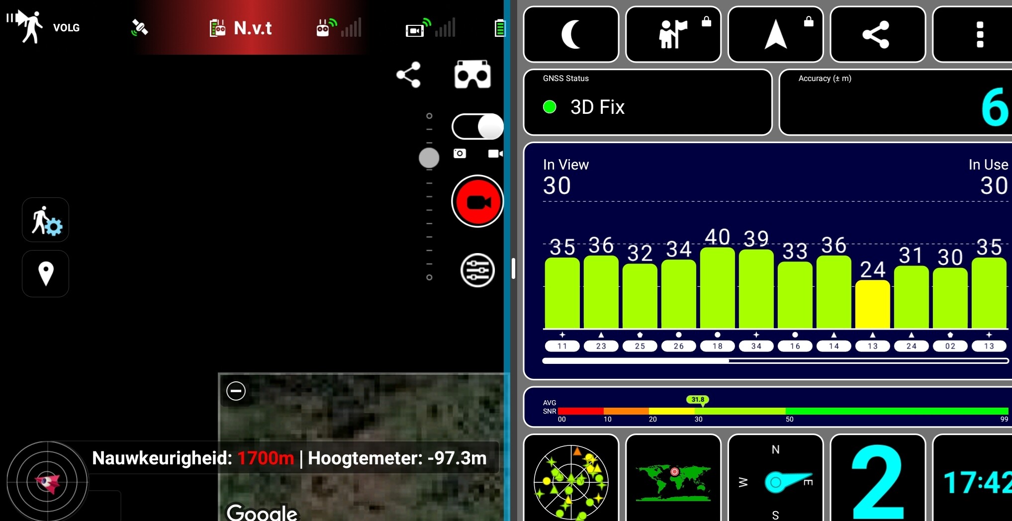

I recognize Mikes issue. Not on an Honor 20 but in my case on a Note 9. In follow mode the accuracy is not of for meters but sometimes even km’s. In open field. It’s driven me crazy. When I check the gps accuracy with another app simultaniously it states the phone gps is accurate within a few meters not the km’s mentioned in Litchi.
Some setting in Litchi or a bug maybe?
Who can help me out.
Thx, GP
