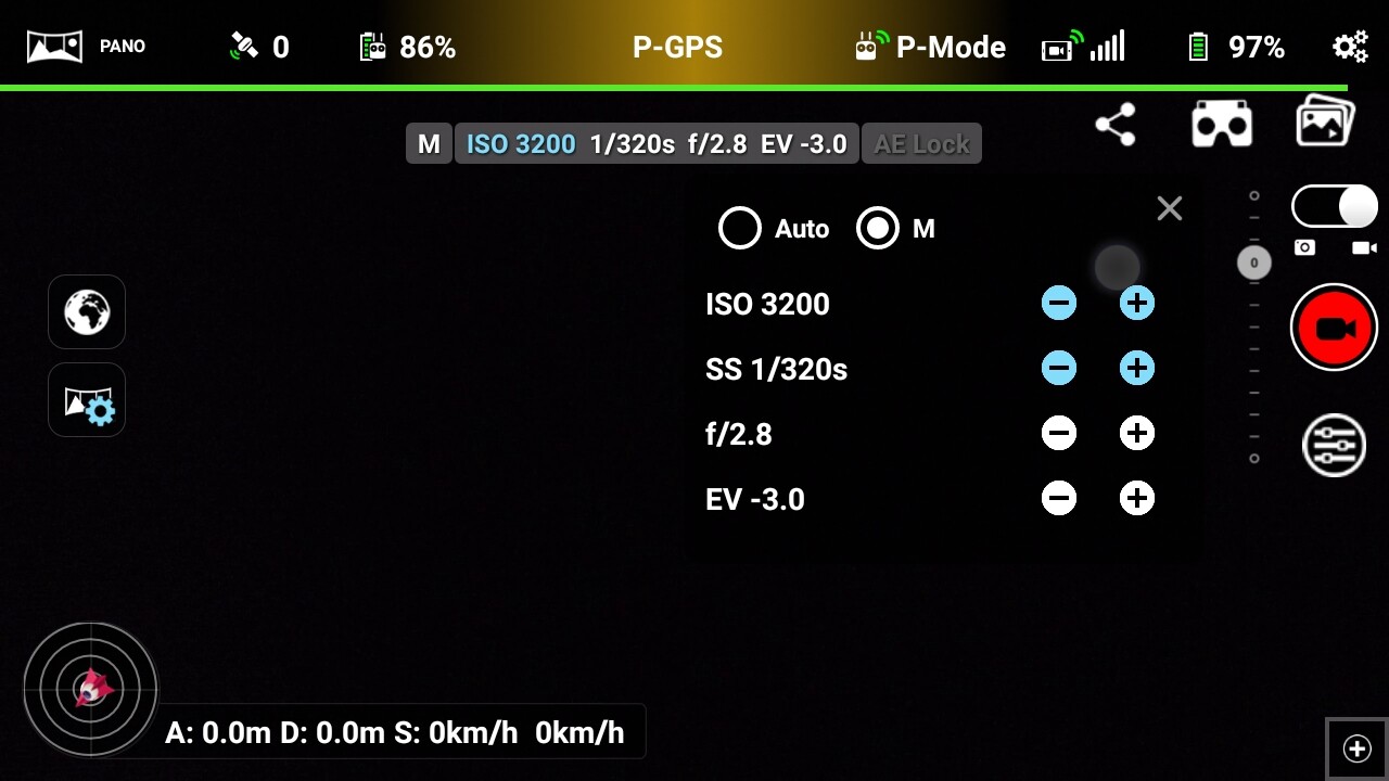

Either set Exposure to Manual

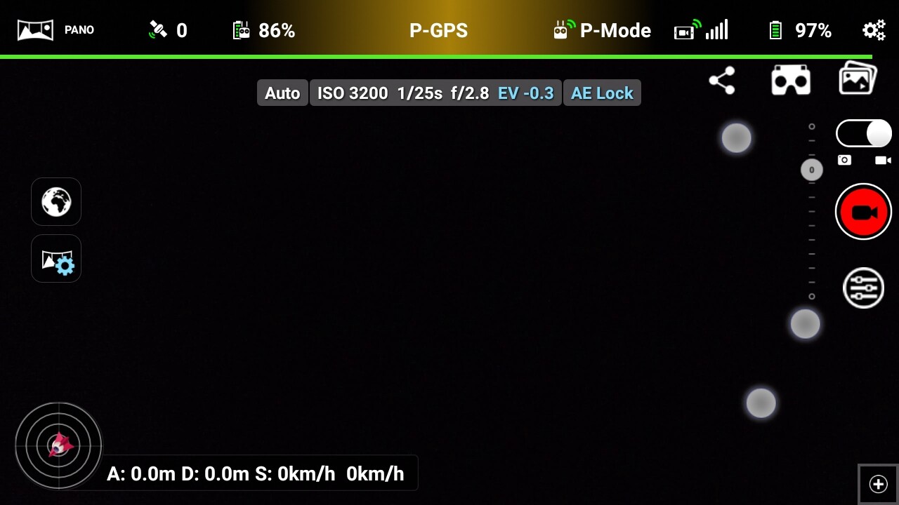

Activate AE Lock

Manual Exposure:
AE Lock Active
Thank you for the detailed explanation. Truthfully I usually look at the screen in bright sunlight and never noticed those settings. I just did a test in a contrasting light setting and had good results. Thank you again.
You should be aware that ae cannot be manually selected. Only block or leave automatically.
