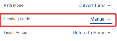

Have you already tried this and found that it does not work? If so, the thing that I would try is setting the “Heading Mode” to “Manual”. This isn’t exactly what you asked for, but it should let you have complete control over the heading of the drone as it flies the configured flight path.
