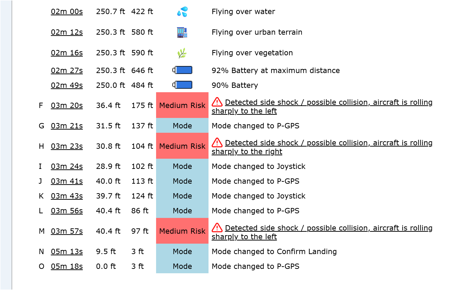

Can anyone confirm if Obstacle Avoidance works in Litchi for the side sensors on the DJI Enterprise drones? It didn’t for me today and Smuck - Airdata UAV records the side impact into a large light pole without any sensor pre-warnings. Luckily only 1 prop was damaged.
UPDATE… I’ve confirmed CO works when Litchi Pilot is running on the controller (no mission running) and running on the controller (with mission loaded). I have not tried it while actually running a mission (Too terrified.)! Has anyone else seen Litchi brake on side sensors warning while executing a mission?
