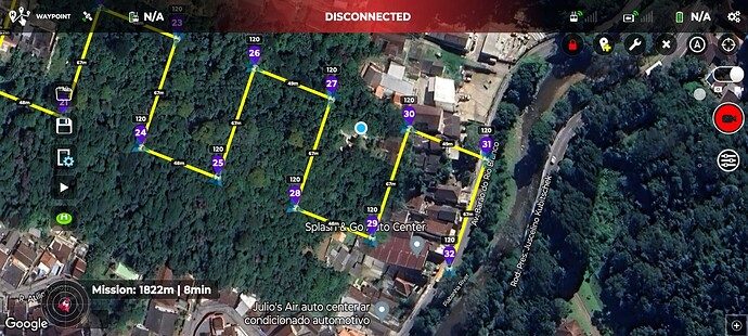

All the waypoints are set on Litchi to 120 meters above the ground, as you can see .
What’s it missed ?

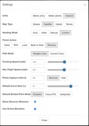

In the Mission Settings, make sure you have ‘Use Online Elevation’ checked:

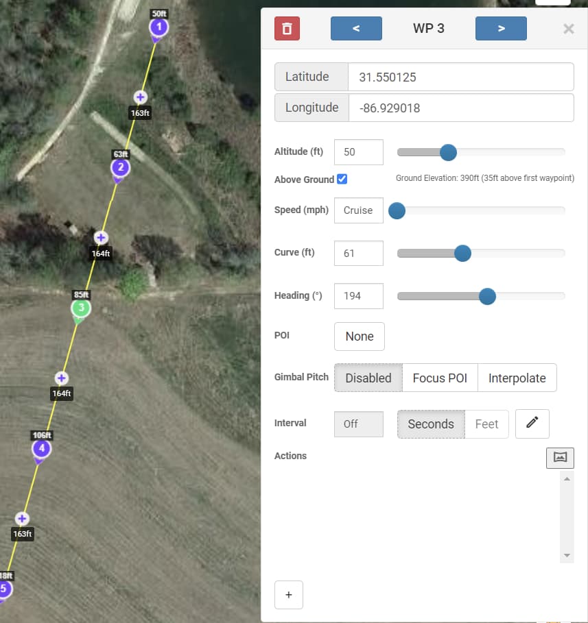

As well as ‘Above Ground’ checked in each Waypoint Setting.
When you ‘click’ and ‘Apply’ the Above Ground setting for each waypoint, you should see the Altitude change from the 120m setting to a different number.
Not in the Waypoint setting, but in the Mission View. For example, my WP03 shows an altitude of 50ft in the Waypoint setting, but 85ft in the Mission view since the altitude of WP03 is 35ft above WP01.
Thanks Sam!
I wasn’t used to check On Line Elevation .
