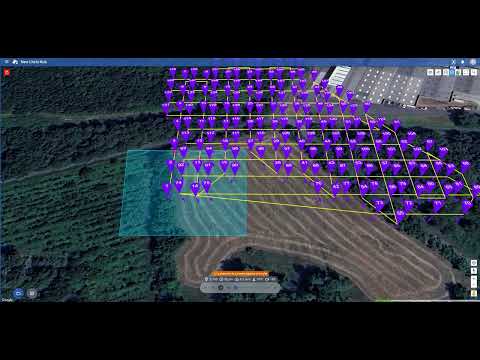

The new Mission Hub includes many new features including a built-in Google Earth view which eliminates the need for an external program to visualize a flight.

in the new Hub how do you fly the mission in 3d? the drone-symbol in the upper right corner only gives a 2D flight not very Helpful.
click the Earth symbol
