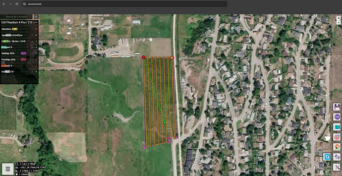

I would suggest you have a look at a website at this address ancient.land it will create a grid flight mission plan that can be imported into FlyLitchi.
The user specifies wich aircraft, flight altitude, desired Ground Sample Distance, flight azimuth, start point, photo overlap% - forwrd and sidelap and gimbal angle -90 to 0 degrees.
Here is a link to the resulting CSV file: Lodge Rd MIssion-58m P4Pro.csv - Google Drive
