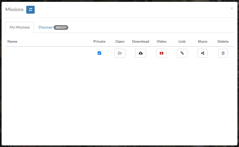

When I click on the “MISSIONS” button in Mission Hub - Litchi, I am presented with various options, one of which is “Download”. When I click on the download icon for a mission, I am given the opportunity to save a file. However, no file extension for the file is given. My questions are:

There is no “Download” menu item in Litchi’s Mission Hub. Litchi does not provide such an option:
Capture
If you are seeing a “Download” menu item, it would suggest that you may have a browser extension installed that added it. Check to see what extensions you have installed. If you find the “offending” extension, check its documentation.

Thanks @Yordie. I’m not sure if that was what the OP meant. He did say:
However, the “Download” button is in the “Open” dialog. The file downloaded is a binary file. There doesn’t appear to be any way to “Upload” it. That doesn’t make it of much use as a backup or anything else.
