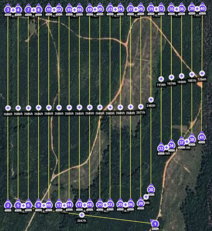

This mission covered over 120 acres (almost 50 hectares) with 41 waypoints. I had to stop and change batteries, then re-start and the previously covered waypoint.

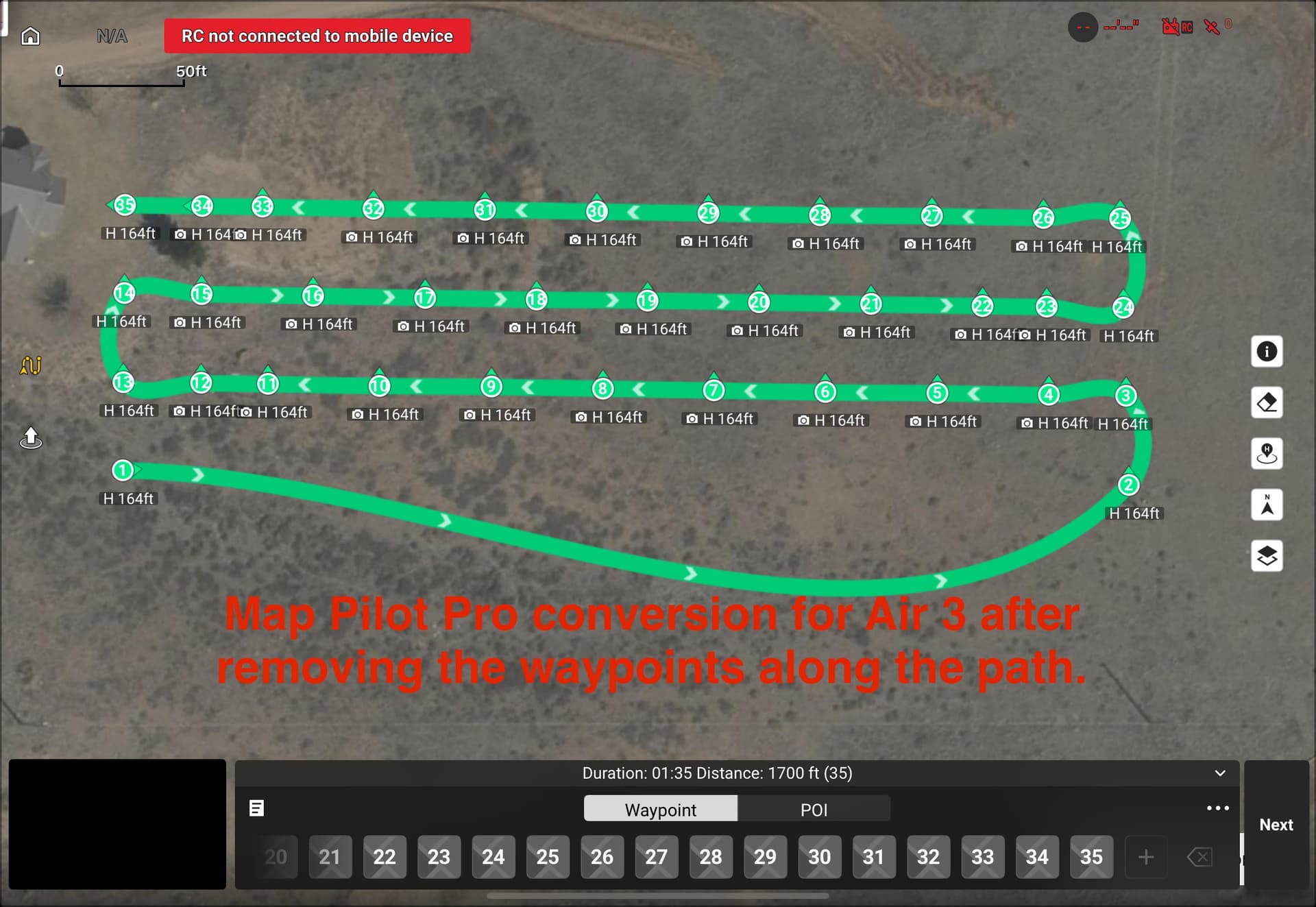

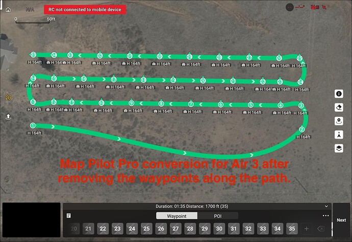

A couple things to be aware of. Depending on which app you use to convert to a DJI waypoints plan then to a DJI KMZ file it can be different. I know that when using either the Map Pilot Pro or Dronelink app it will place many waypoints along the path in order for it to have a straight path. The DJI Fly waypoints uses Bézier curves and cannot be set to a straight path. If you remove all the waypoints along each leg except for waypoint at each end you will see the path goes to a curved path and goes all wonky.

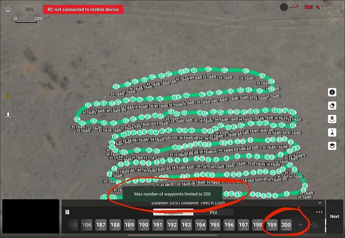

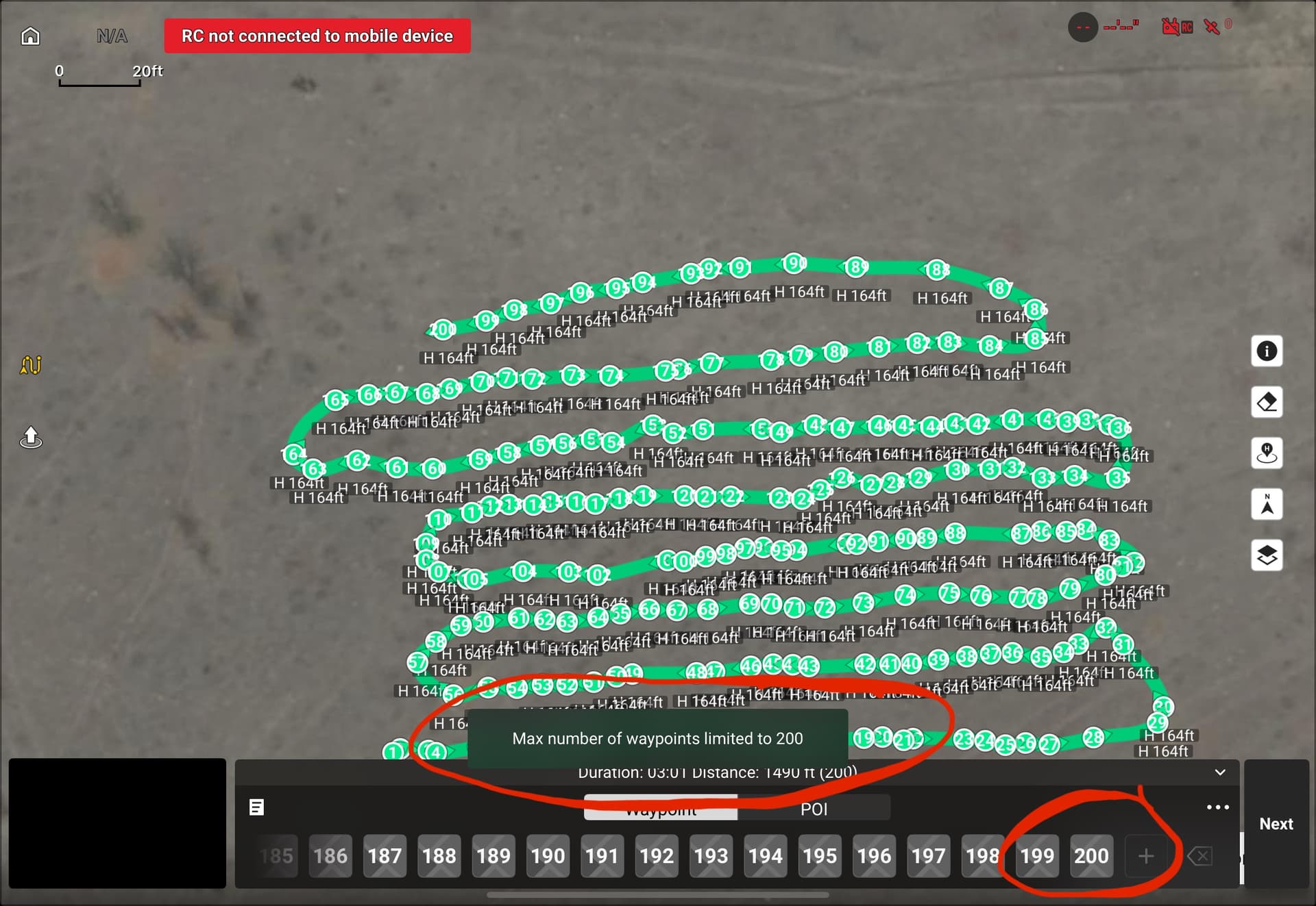

I know when specifically using the Map Pilot Pro app with larger maps it will split up the mapping mission into a couple or several smaller missions automatically with 200 waypoints each. It does explain this in the Map Pilot Pro help articles. However, when using the Dronelink app which is what I use it will work with larger maps with hundreds of waypoints all in one mission. So there can be a difference on how it’s converted depending on which app you use. If you search for an article on how to use the DJI Waypoints it does say 200 max allowed. If you go into the DJI Fly app and create a large waypoint path mission it will not allow you to go above 200. So there are many things which may affect the use of DJI Waypoints. Just some info to be aware of. Enjoy.
