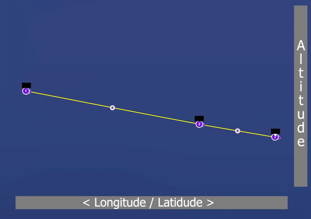

To create a DJI Fly Flight Plan (waypoint mission), you have to export to KMZ, not KML.
When the flight plan only has 2 waypoints, then YES, otherwise NO.
DJI Fly doesn’t use Straight Lines.
It creates a 3d flight path with smooth curves through all waypoints.
What this flight path looks like depends on the position in 3d space of the adjacent waypoints.

If you are referring to the “Distance Interval” function in Litchi it is important to know that while the WPML language does support distance (and time) intervals, the DJI implementation in DJI Fly does not support them. When a distance interval is configured in a KMZ file, and loaded into DJI Fly and executed, the drone will only take one photo at the end of the sequence.
The drone will fly the expected route but will not capture the interval photos.
While it is true that DJI Fly does not provide a way to create a straight-line mission, the WPML language does support them. If a straight-line Litchi mission is converted into a KMZ file and loaded into DJI Fly, mission displayed within DJI Fly may look incorrect, but it will execute the straight-line mission properly.
It will. When a grid mission is exported from the new Mission Hub as a KMZ file, the WPML code includes the “use straight line” parameter at each waypoint with the proper “waypointHeadingMode” for straight-line missions.
Give it a try and report back.
