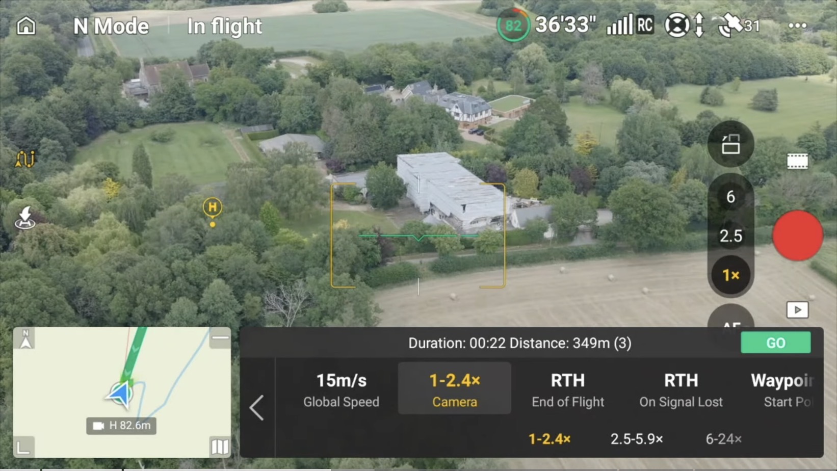

I would also not always trust what DJI tells you until you can confirm, as this screenshot from a Mavic 4 Pro youtube video showing the global mission settings seems to imply you choose one camera for the entire flight like the other drone models that DJI Fly support (Air 3S, etc):
Exactly, I came across that screenshot too, adding to the confusion. I’m still looking around for someone with a mavic 4 pro that can test. Should be fairly easy to do so.
