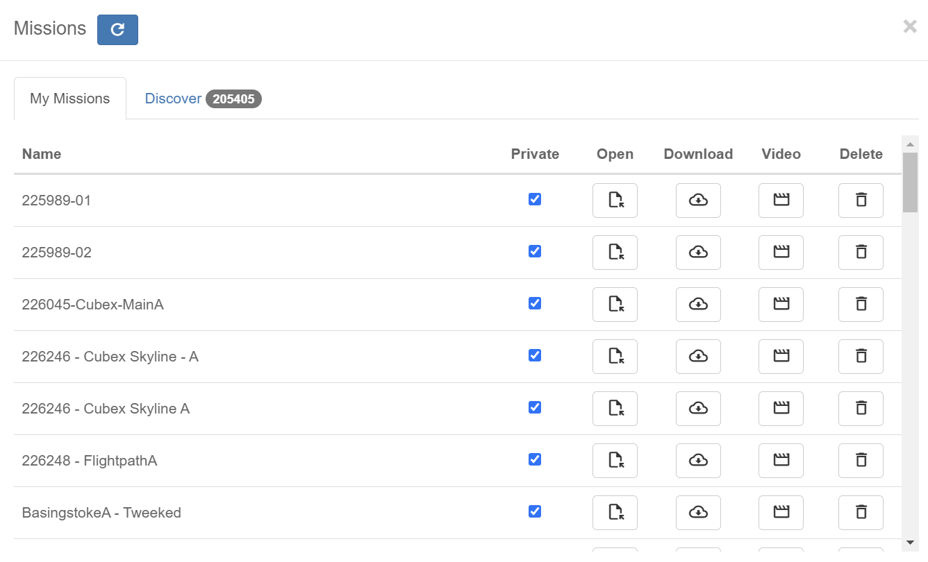

Thanks for the reply. I’ve checked this and sync is on. I also synced the license. No change.
On Mission Hub I see all my missions:
But on the controller, the box is still empty.

I have not heard of this happening before. The only things that should be necessary are to be logged into both the Mission Hub and the Litchi app with the same Litchi account and the occasional need to select the “Check and sync license” option.
What happens if you open an old mission on the Mission Hub and then save it again. Does it then appear in the app?
I’ll give that a try.
FWIW, I had this same issue last week with my Mavic 2 Pro. I had to open each flight in Mission Control and save them, then they appeared on my Smart Controller.
I had the same issue recently. The only thing that worked for me was deleting the Litchi app from my Smart Controller and reinstalling it. Everything returned to normal after that.
