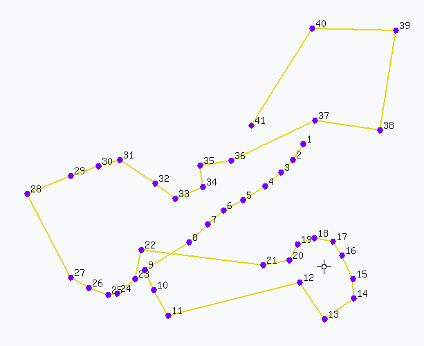

Your mission:
Daniele-00

Thank you. Next time I will try to do routes with less WP. I’m not clear what you mean by curves at 0. Where can I find out more information?
Each waypoint has a number of settings, “Curve” is one of them.
When you click on WP25 you will see a Curve of 23m.
Also be carefull with different waypoint heights.
DJI creates it’s curves in ALL dimensions.
Because of this the drone will fly lower that 15m between WP5 & WP6 in your mission.

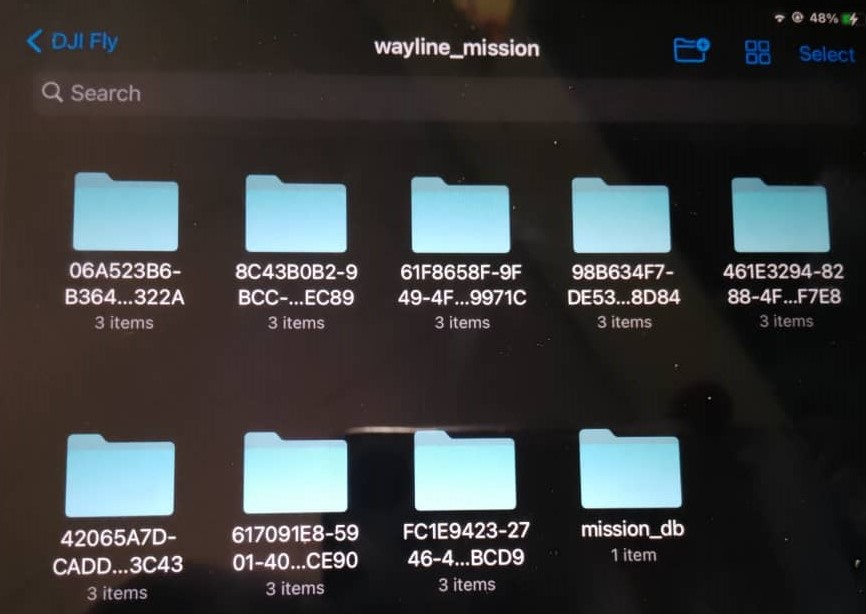

In trying to figure out where in my cable-connected iPad’s DJI Fly file folder I will need to copy the KMZ file, I found these two selections of files, but then became unsure about where this imported KMZ file will need to be copied, AND which file name must initially be used as a replacement of the KMZ’s file name.

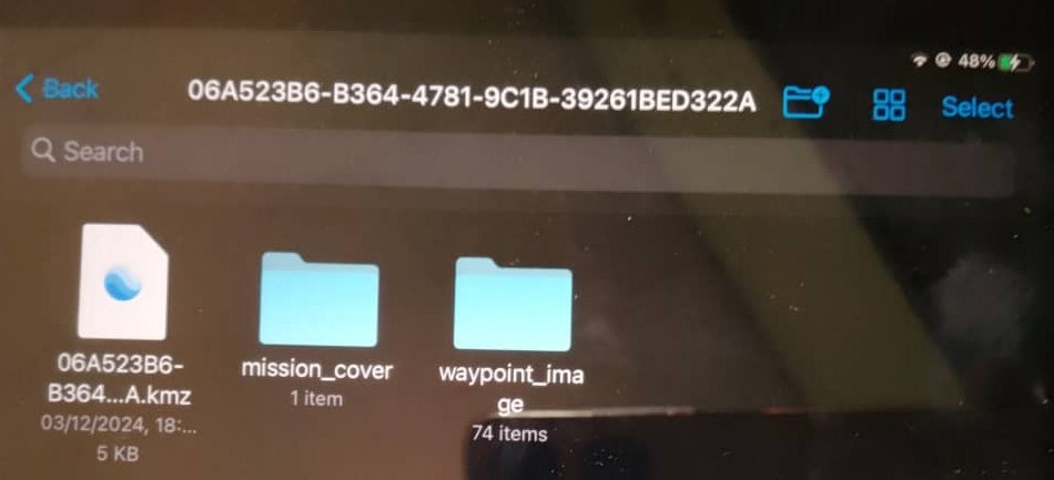

I then clicked on the first file in this listing, whose name starts with 06A… which then listed out the files in that folder as follows.
My guess is that the KMZ file listed first is the one to be replaced with the imported KMZ file, whose name must be copied verbatim for the newly saved KMZ file. However, at this point, I felt it best to consult The Oracle for any clarification that can be made.

Because these names used in the wayline_mission folder are meaningless to humans, people normally create a “dummy” mission then identify that newly created mission by looking at the dates of these files. The file with the most recent date would be the last mission created. The file you show was created on 3/12/2024. If that corresponds to the mission you want to replace, go ahead and replace it with the KMZ file created with my utility.
This clarifying reply is appreciated, Wes. In replacing the KMZ file already created as a waypoint mission in this DJI Fly file, am I correct in my understanding that I must initially copy verbatim as the title of the newly imported KMZ file, that alphanumeric string preceding the “.kmz” suffix in the DJI Fly screenshot above, in this case, the string 06A523B6-B364…A.kmz ?
Yes, the filename must remain exactly the same as the original/dummy mission.
