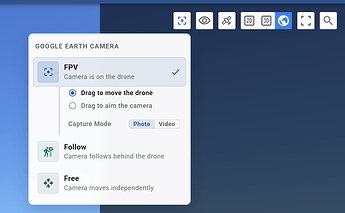

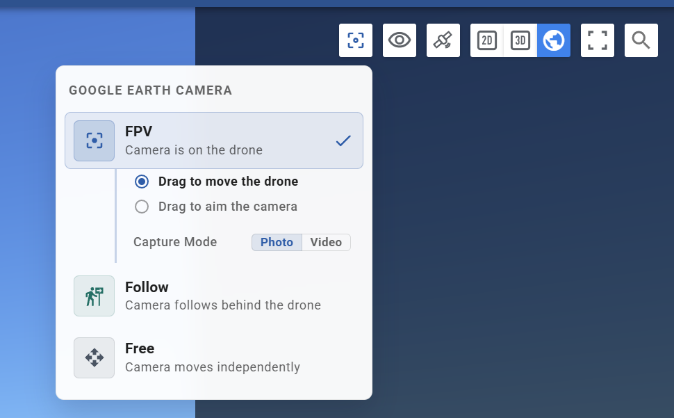

My problem though is the results. It’s a typical orbit around a building and I want to ensure I have some horizon in the video. So the first hurdle is adjusting the POI height to get the desired framing. This is made a little more difficult because the simulation shows a 4:3 aspect ratio but I am shooting at 16:9 so while the simulation looks fine, the results are cropped and part of the horizon might get left out. It would be helpful to see a true 16:9 aspect ratio. I know the projection has two red lines to show the area that will be cropped out but it would be nice to see that in the simulated view.

You can change the aspect ratio in the simulation by changing the Capture Mode between Photo and Video
