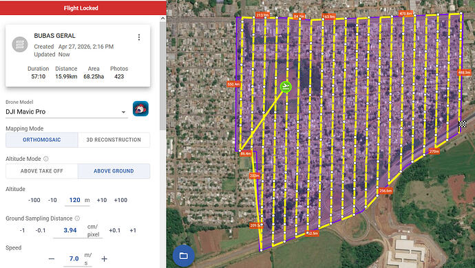

When creating an Area Mapping on Litchi Hub, I would like to invert the start and the end of the flight (usually, Litchi Hub makes the end of the flight further from the planned Home Point).
Check image below to see what I mean
I would like to end the mission closer to the planned departure point.
Is there a feature I did’t see in the hub to do this?
Any tips?
Thanks in advance.
Pietro S. F.
The way the mission planner is set up is for the mission to start as close as possible to the selected home location and that cannot be changed. The home point is specified so that the ground elevation of the take-off location is known. If your mapping area is relatively flat or there is another, preferred take-off location that is at the same elevation as the selected take-off location you can take off from that location despite what was selected in the Hub for this mission.
