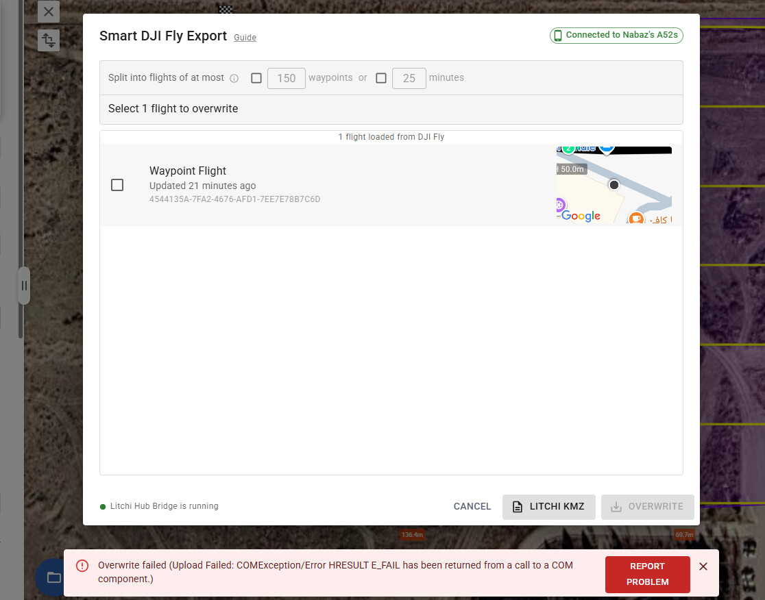

I want to export a mission to Dji fly on mobile using Litchi Fly Bridge, but whenever I click on overwrite it keeps showing this error message:
Overwrite failed (Backup Failed: COMException/Error HRESULT E_FAIL has been returned from a call to a COM component

The issue is either your USB cable, USB port/computer or the mobile device you are using.
Note that samsung phones/tablets from 2019-2021 era are not supported as they often have issues with any MTP software due to broken samsung software. Your phone seems to meet that criteria.
Thanks,
regarding the USB, I changed the cable and the usb port, got same issue. looks like there is an issue with my mobile.
I will do the manual overwrite.
thank for your reply.
I had the same issue. I switched to a good USB cable plugged DIRECTLY into the laptop *not through a usb hub) and my upload started to wirk fine.
