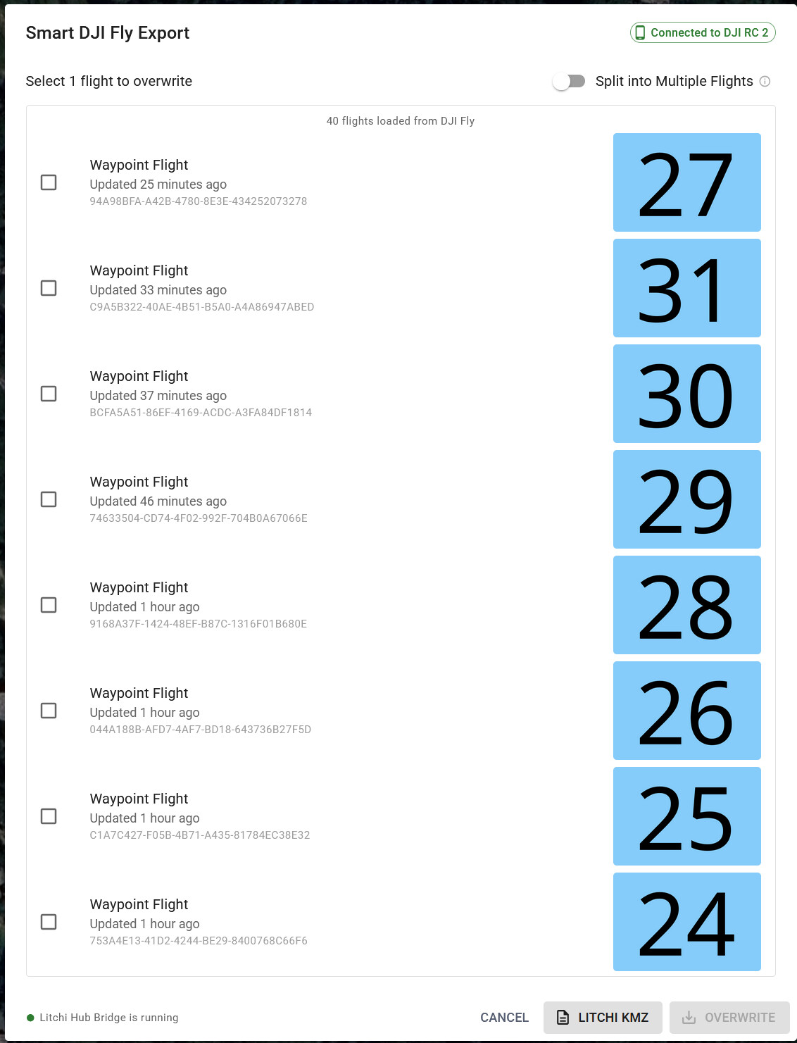

Litchi Bridge Request NOT to overwrite waypoint images
As visible on this screenshot - I made my own images to easily locate data and select my flights.
I find numbers A LOT easier to work with than images which are so small that many look the same anyway.
So can I please request to NOT overwrite my own images?
If other users still prefer things to happen in the back beyond their control, that’s great, just make it a checkbox (and remember the choice of the user) then both overwriting the images or not overwriting can be set per user preference.
Thank you for your consideration

my problem isn’t with the Litchi hub, but with the display size of the RC.
I can’t recognize the flights on the RC display, because it’s too small.
And since we can’t control the naming on android (RC is running android) I figured then I simply do it using the images and give them a number.
The best solution is of course being able to use the Litchi Hub names and overwrite the default RC names, but that’s impossible as I understand as we don’t have access to these names.
Anyway if overwriting the images is desired - that’s fine - then I won’t use the bridge app and simply manually copy paste all files.
A lot of extra work, but then at least I know what I’m doing and simply maintain a spreadsheet file to avoid confusion.

That’s why i edited the waypoint mission images simply with a number, easy to recognize.
