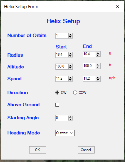

Use Namirda’s Virtual Litchi Mission (the desktop program).
Set your POI, then use the Helix Mission around that POI.
Here is an example for the setup:

No, its built into the program.
No, its created totally in the VLM program.
Here is the mission created by the Setup screen that I posted.
