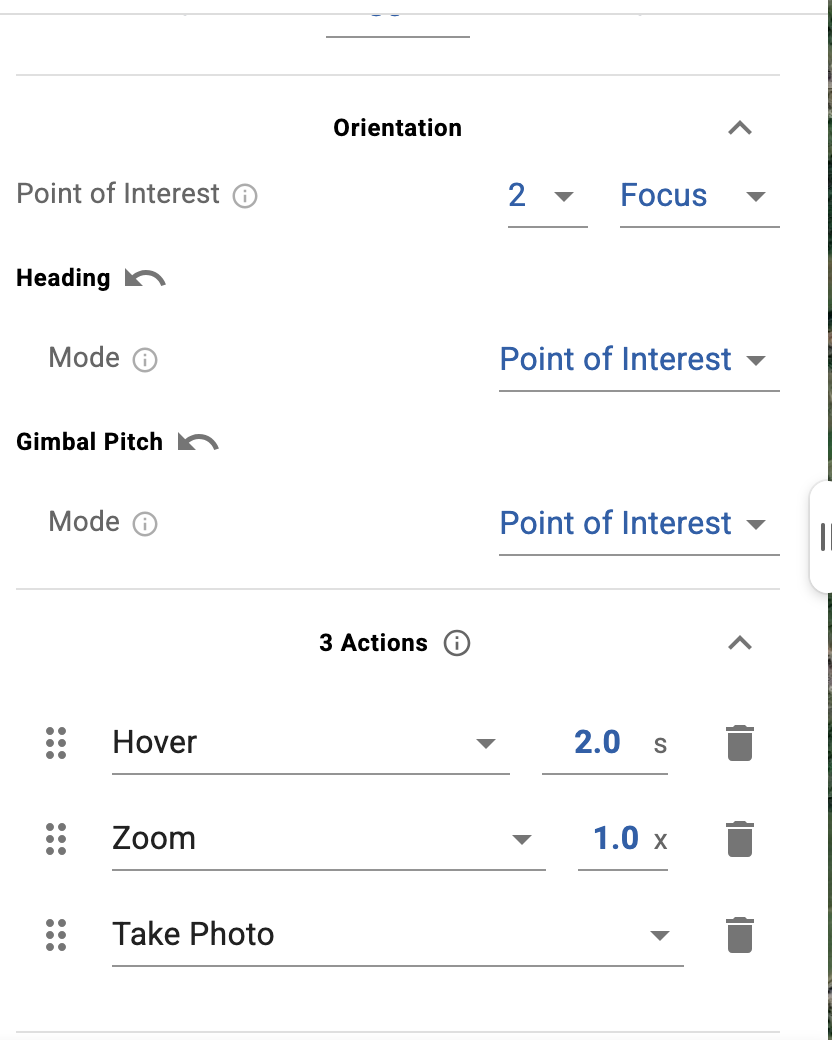

I put a bunch (8 or so) of waypoints close to each other with focus on two POI’s. 1st four waypoints on POI one, last four waypoints on POI two. The 1st WP seemed to have triggered the “take photo” action but the rest seem off. Instead of photographing the POI’s, it took several photo’s from yards that was were further along the flight path. Flight speed is only 2 m/s so I don’t think that is the issue.
I even got a photo near (?) a waypoint that was not set for action “take photo”. So it seems there is some substantial delay somewhere.

With DJI Fly, waypoint mode is designed for shooting cinematic videos primarily. This means the drone will transition its heading and gimbal pitch from waypoint to waypoint. Because the rate of change during transition is limited by DJI (to achieve cinematic results), if 2 waypoints are very close to each other, the drone won’t have enough time to transition to your target heading or gimbal pitch. You can help it to have more time by reducing the speed between the 2 waypoints but in the end you’ll need some space between the waypoints anyway.
On top of this, remember that with DJI Fly’s waypoint mode, the drone will not stop at a waypoint unless there is a Hover action.
Straight line path mode probably won’t solve your issues but always worth trying.
There is no min. space between waypoints AFAIK.

Speed is 2m/s, with waypoints close like that you will hit the min photo interval limit. Photos cannot be taken faster than every 2 sec for a Mini 5 Pro and that’s with JPG not RAW.
There seems to also be an issue with your flight regarding elevation, where did you plan/edit that flight? Hover the waypoints to see the issue with elevation data. By the way if you simulate the flight you will also see that the drone is not taking all photos (enable sound effects in settings).
I can report that 2 seconds of hover (cfr. my screenshot) fixes it perfectly. Next is to try 1 second. Oh excellent tip! I did not realise the simulation caught it. I planned it on the Lichi hub, exported the kmz and uploaded it to the drone. Maybe the skewed elevation data is because certain scripting is blocked with no script (guessing it might not have been able to import dem data)? Regardless the (large) elevation number, it was at safe altitude (did the elevation map on another website by auto interpolating all the points between the way points)
