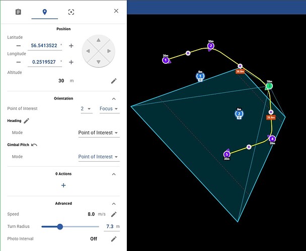

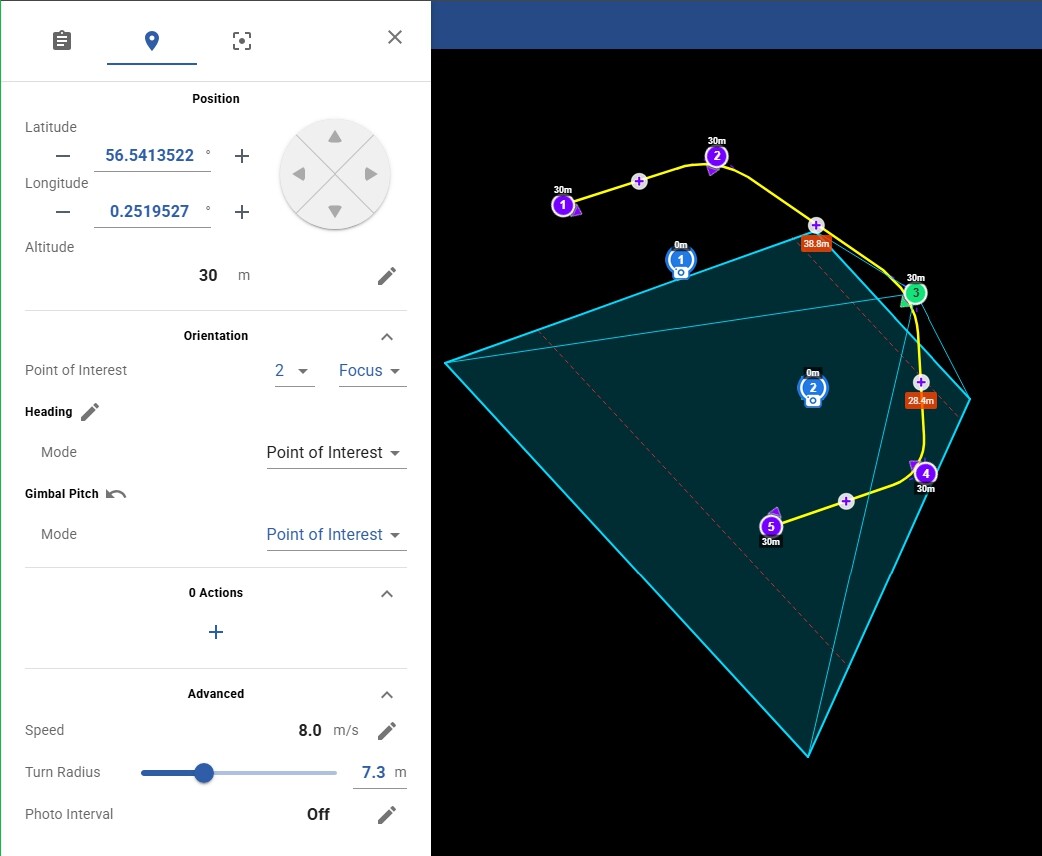

Thanks Wes, here are two links
points but no pictures, made this with my iPad
https://flylitchi.com/hub?m=iuUGv2I5SY#
does not point, made this on my desktop.
https://flylitchi.com/hub?m=Mu8JoLPBqW#
Thanks for the help
Sam
In the old Mission Hub you will need to select “Missions” → “Open” and then uncheck the “Private” checkbox. That will make these links work.

After seeing the first mission that you posted, it confirms that my first response to you was correct.
Your clue should have been that the waypoint icons were not pointing at your POIs.

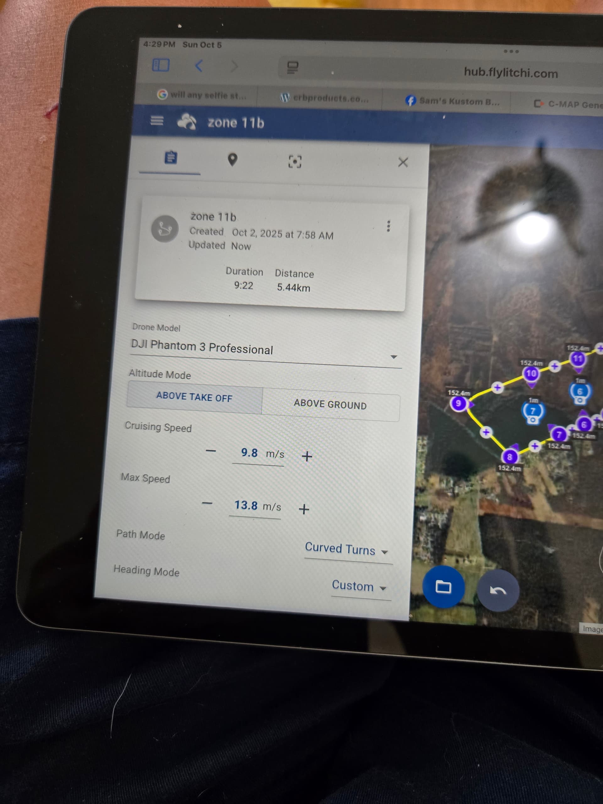

Thanks Wes, so now I using the beta they point to the poi. , but still does not take pictures, can you see the mission setup? I really need the pictures in the same spot for two years contract.
I have figured out how get focus on poi, went to the beta version. But it will not take pictures based on feet or seconds. Years passed it would do the pictures, I can manually take them, and do video manually, but auto function will not work. Thanks ahead sam
You shared two different missions from the old hub. Now you are saying you are the “beta”. Are you referring to the beta Hub? Mission Hub version 2? Or Litchi Pilot (beta)? What drone are you using? Without knowing which hub you are using and what drone, it’s a bit difficult to answer your questions.
OK, so I could not make the old mission hub point to poi. So I tryed the litchi hub, I found where it supported my dji professional 3 drone. I set up a few missions and it Flys them perfectly but does not take any pictures automatically, I can take pictures manually . I can do video but I start and stop that manually So I as scoured the instructions and on the app, and I am pretty sure I have have the settings correct. But the again I could be missing something. Thanks Sam

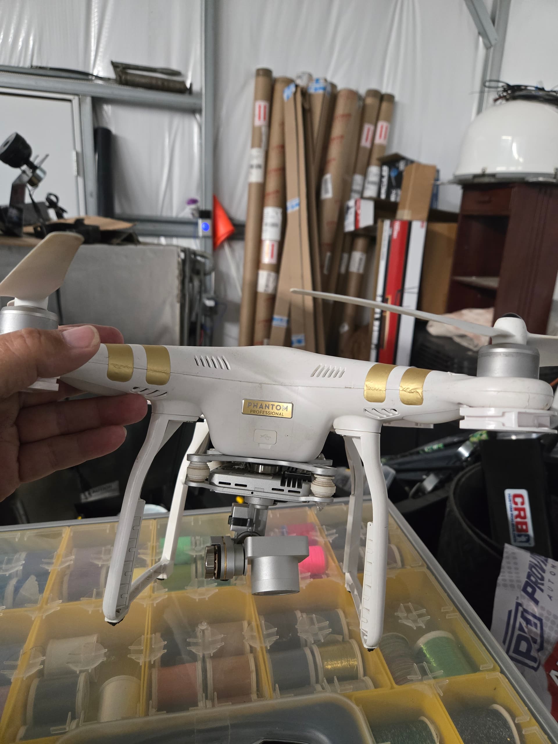

My aircraft is a dji phantom professional 3 pictured below.
It flew missions great a few years back. And I have aways had my heading set to POI. Sorry I hadn’t explained that, but on the
