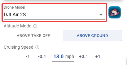

The most likely cause for this is that in the new Mission Hub, a newer DJI drone was selected (such as the Mini3, Mini 4, Air 3S, etc.) for the missions that do not open. When this is done, those missions created for newer drones will not display properly (or at all) in the original Litchi app. The solution is to only attempt to open missions for older DJI drones (Mavic 2 Pro/Zoom, Air 2s, etc.) in the older iOS Litchi app.

I use the new Mission Hub and I use iOS devices. All missions created for those drones supported by the iOS app (original Litchi app) display properly in the Litchi app. If they do not, you have most likely selected a drone that is not supported by the original Litchi app.

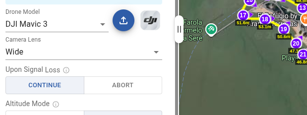

For a mission that does not load in the iOS app, what drone is selected for that mission in the hub?
All of them are like this one:
That would explain it. The Mavic 3 is not supported in the original Litchi app. That is why the mission does not display.
This does not mean that you need to change the drone model in your missions. It just means that missions like this cannot be opened in the original Litchi app. This mission is appropriate for exporting directly to DJI Fly.
