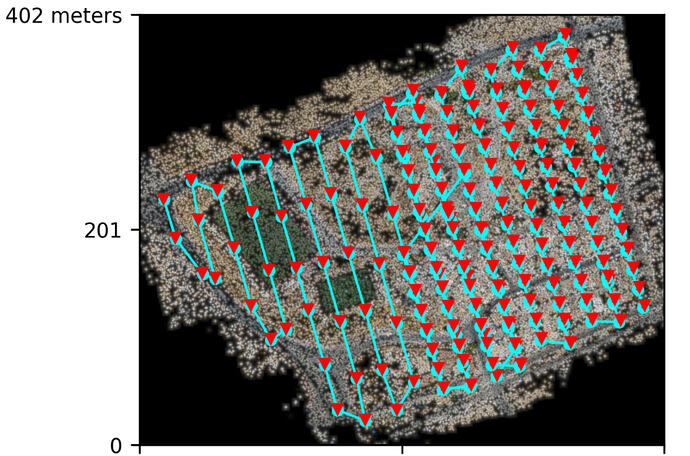

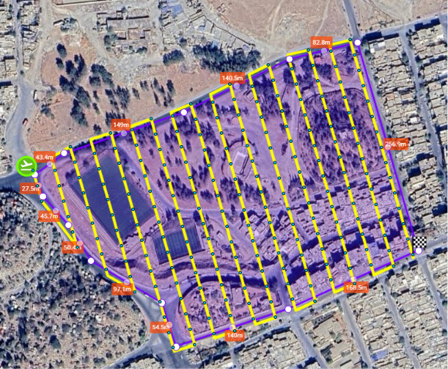

I used a mini4pro to capture an area, as in the plan, everything is good, regular waypoint to capture images.
however, after running the mission, if you notice in the left of the area, there are missing waypoints not captured by the app:

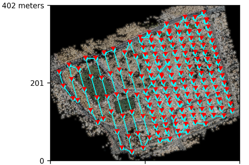

this a screenshot of the report:
(note: you would see path crossing at the middle, it is caused by overheating my phone, I had to return the drone, wait then rerun the mission)
does anyone have any explanation, why there are missing images at the beginning of the mission? any cause for that?
link to the mission:
Strange, I ran your mission in Litchi Pilot’s simulator (long press on top bar to enter simulator mode) and it took the photos where it should (more than what is shown on your report). If anything it should be more photos rather than less due to a known issue when using AGL where the drone sometimes can take 2 photos instead of just one at each photo location.
