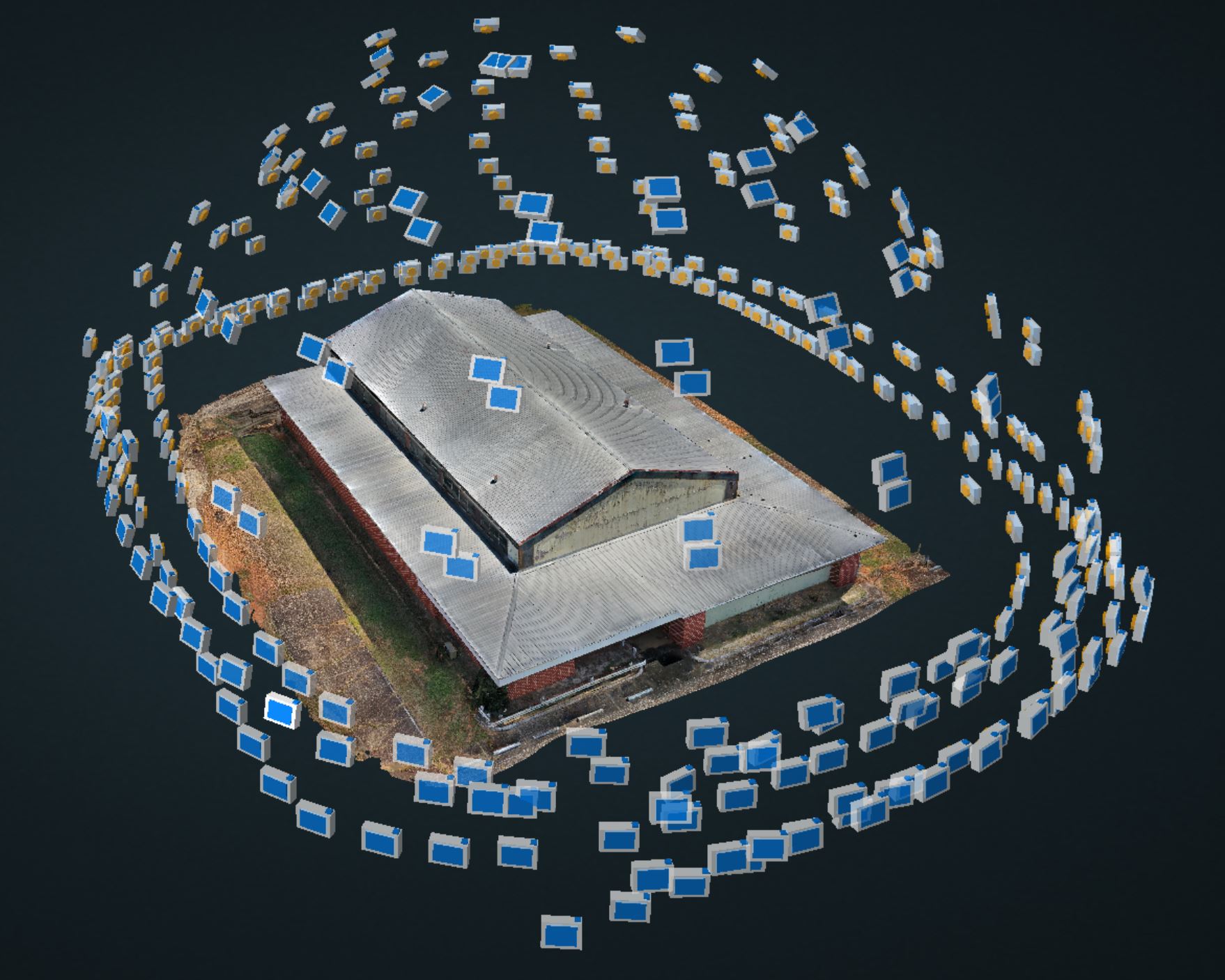

On one of my projects, I used spiral flights varying from 10 ft AGL to 150 ft AGL. I had the luxury of fully open territory around the building.
Here are the camera positions .
In a case like yours, yes, it’s very interesting.
