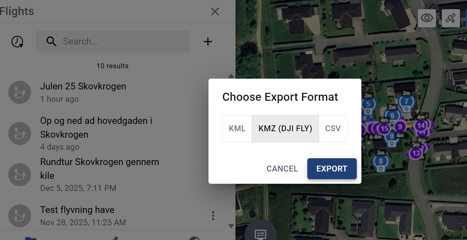

I use Litchi Hub to make missions on my windows PC and export the kmz file to my download window, but now I get this message:
I really don’t understand what to do. I don’t have DJI Fly on my windows laptop, and I only have one Mini 4 Pro.

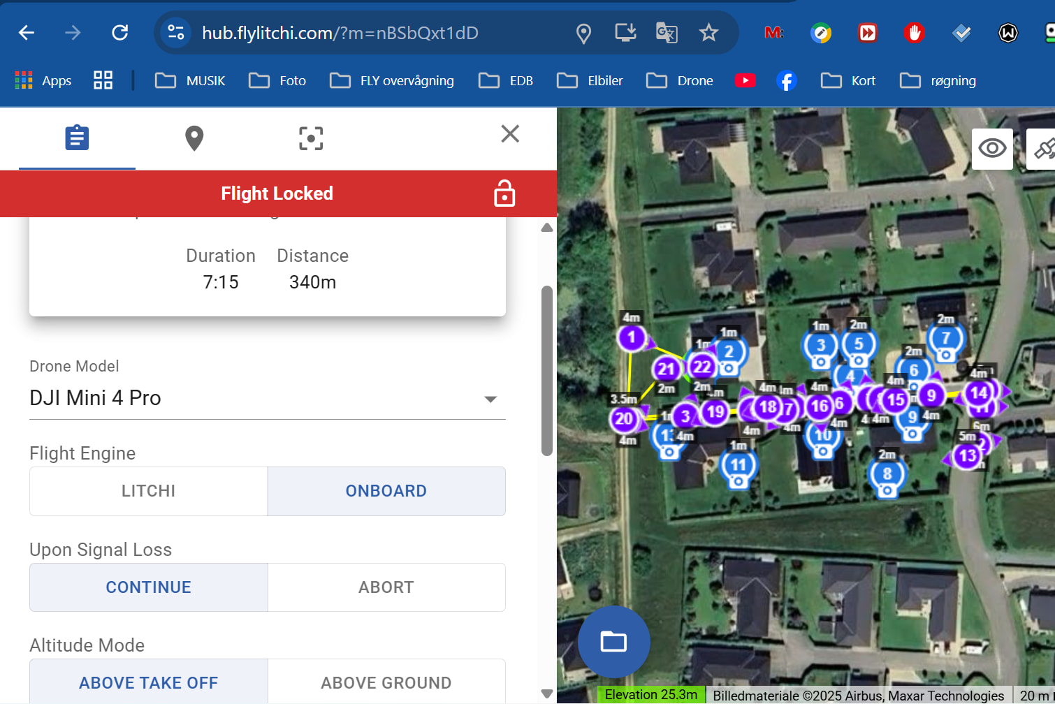

You have to select the ONBOARD Flight Engine, NOT the LITCHI Flight Engine.
(Under the Drone Model selection)
Thanks Tribar
But I don’t se any difference:

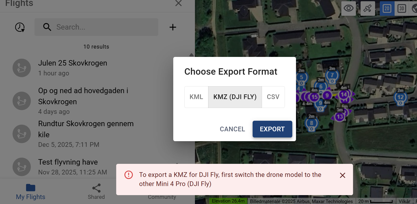

I still get this message:
There are 2 Mini 4 Pro drones listed, 1 under “Litchi Pilot”, and 1 under “DJI Fly” (in blue).
You have to choose the one under “DJI Fly”.
If you don’t see both of them, reload the page of your browser.
Hi Tribar
That helped. I had no idea it was pointing to the wrong drone. Your answer gave me the opportunity to look more closely under “Drone model” and then I could see that there was also one under DJI Fly.
