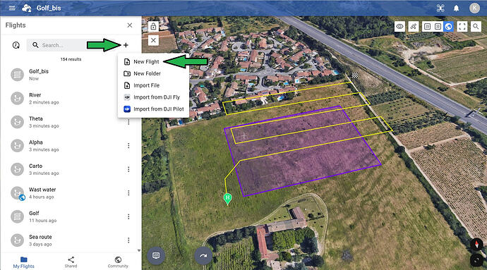

1. Plan your flight in Litchi Hub

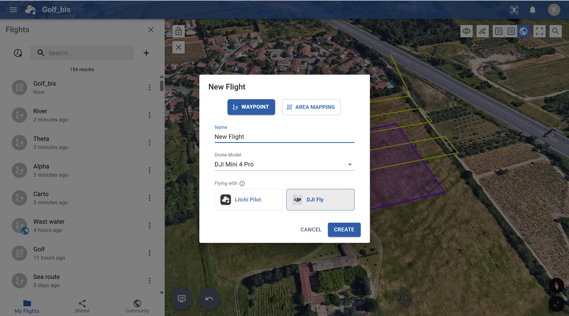

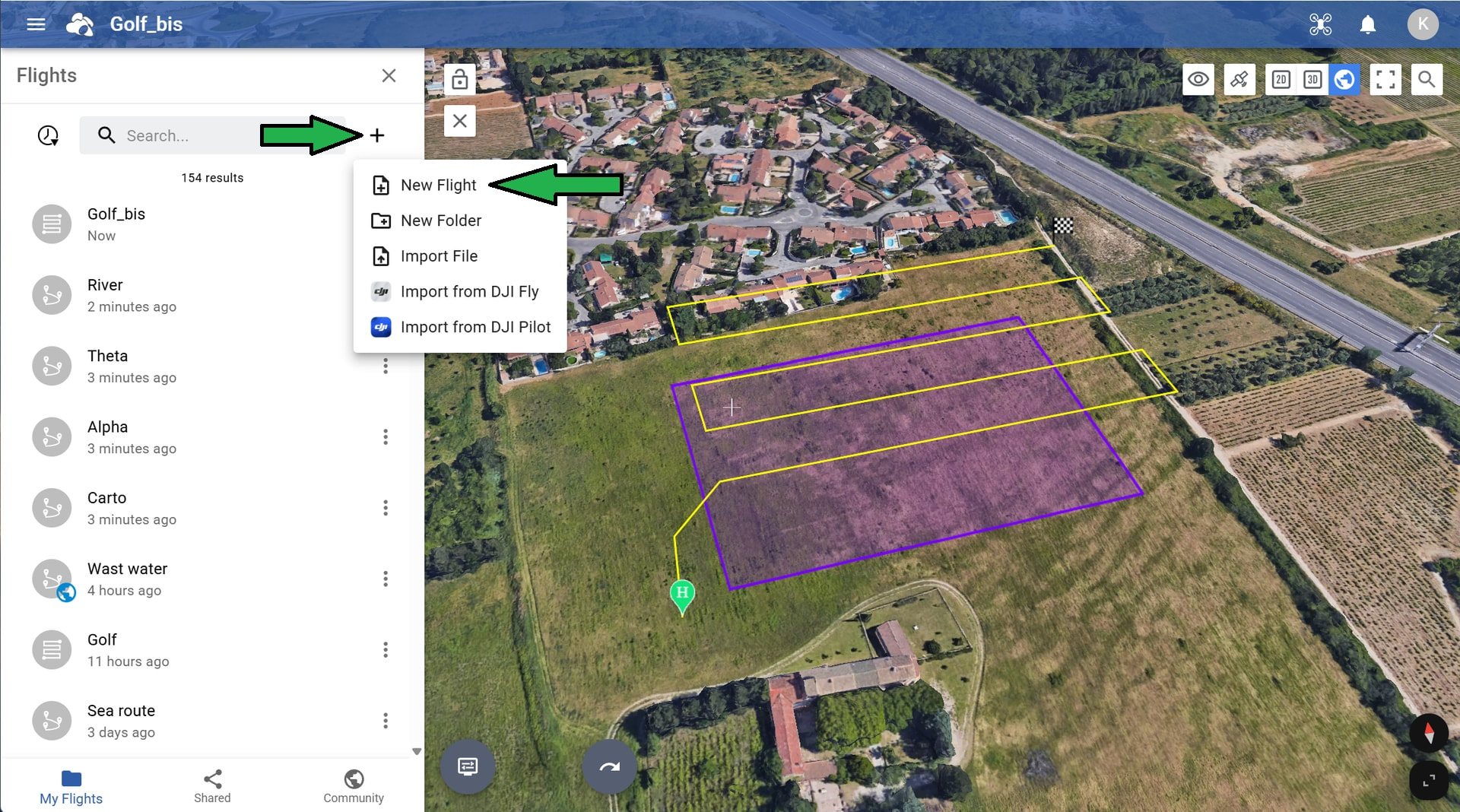

Head to https://hub.flylitchi.com/ and open the Flight Library (blue folder button in bottom left corner). Then click on “+” and “New Flight” to create your waypoint flight making sure to select your supported drone model and DJI Fly app in the prompt.
You can then starting planning your flight within Litchi Hub and continue this guide when you’re ready to export.

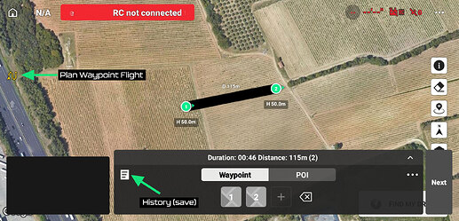

2. Create a waypoint flight in DJI Fly (optional for iPhone/iPad)
  1. Open the DJI Fly app (drone connection not required)
  2. Enter the Camera View then tap on the Plan Waypoint Flight button
  3. Place 2 waypoints on the map, preferably near the same location as the Litchi Hub flight
  4. Tap on History button then Save the waypoint flight
  5. Close the DJI Fly app
Internally, this will create a .kmz file in the DJI Fly app storage on your mobile device/DJI RC.

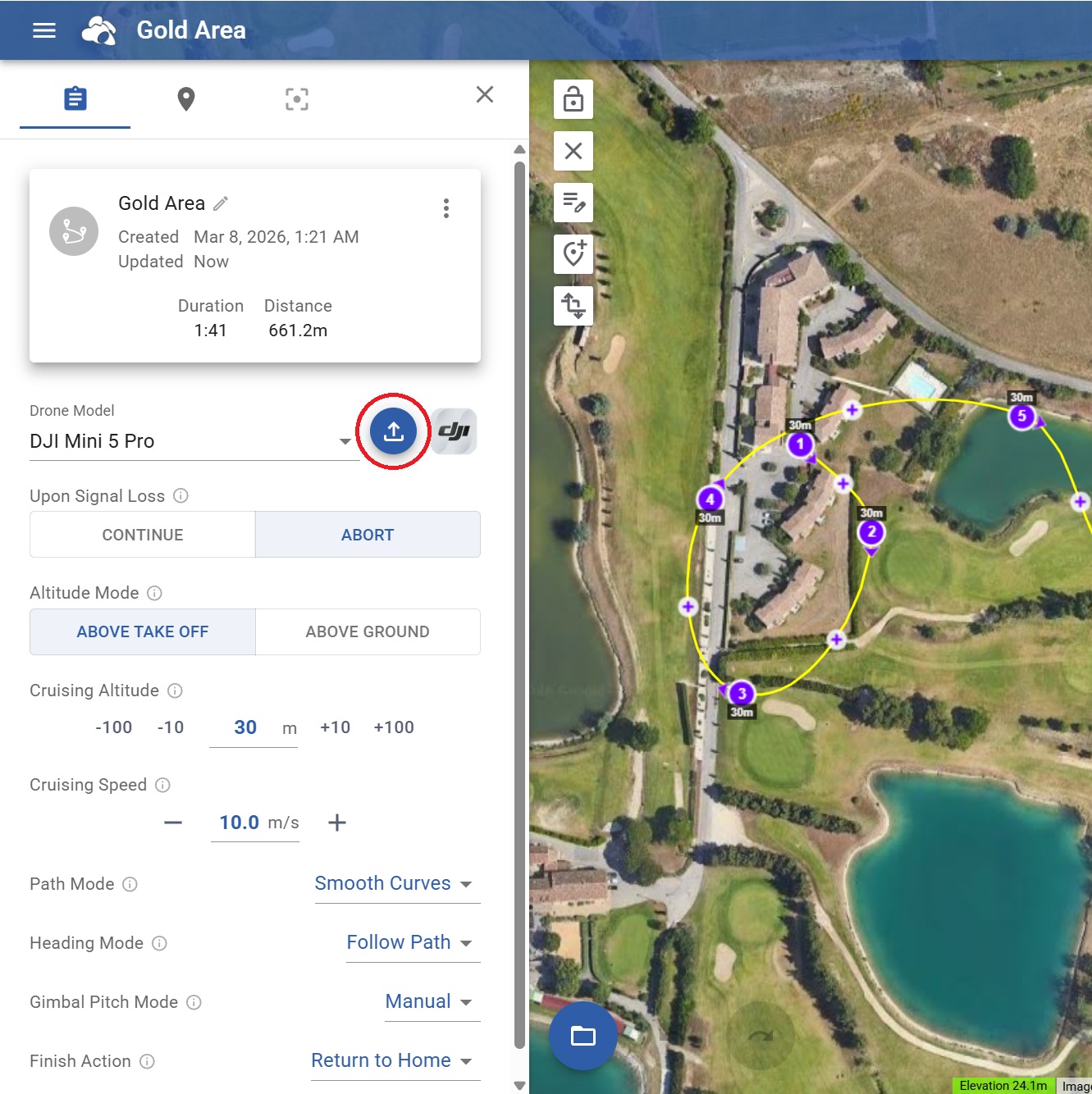

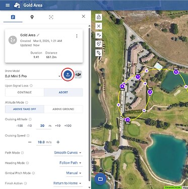

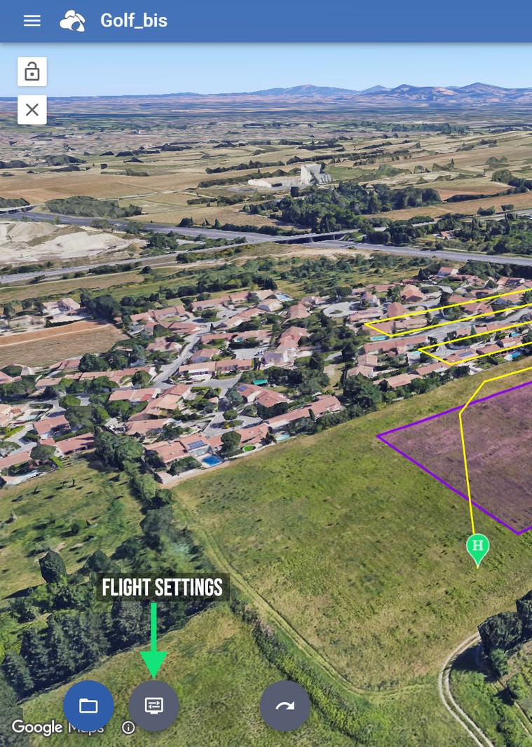

In Litchi Hub, open the flight settings and click the blue Export button.

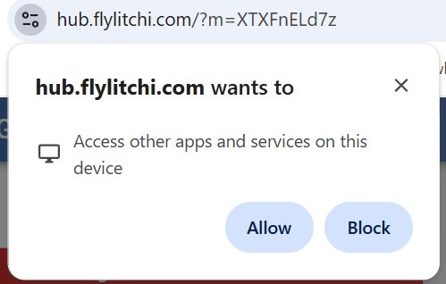

Some browsers (Chrome and others) will ask you to grant the ‘Apps on device’ permission to Litchi Hub. This permission is required for Smart DJI Fly Export so make sure to allow it.

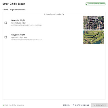

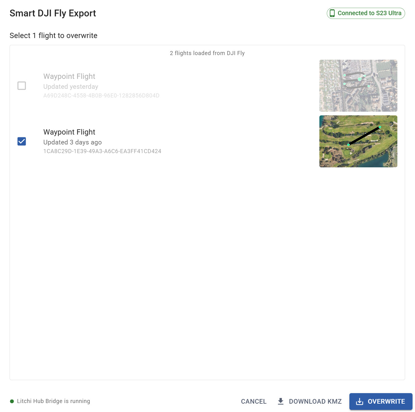

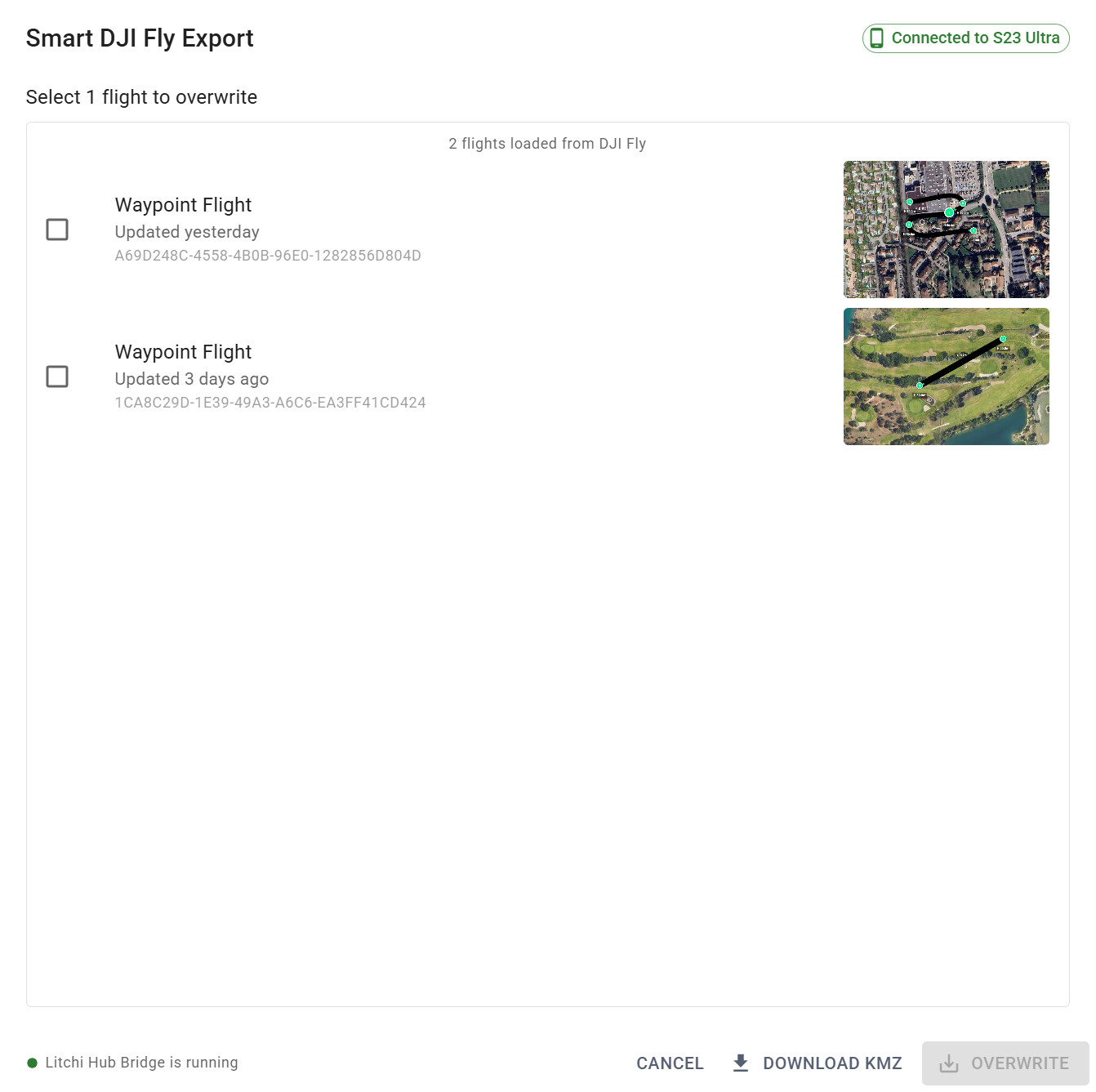

A. Smart Export using Litchi Hub Bridge (recommended)
  1. Download, install and start Litchi Hub Bridge. Note that Litchi Hub Bridge is designed to run in the background so there is no user interface for it other than a system tray/menu bar icon.
  1. Connect your mobile device or DJI RC, unlock it, then select File Transfer USB mode on Android or tap Trust This Computer on iOS. You should then see your DJI Fly waypoint flights listed
  2. Select the flight to replace and click the “OVERWRITE” button. iPhone/iPad users can also chose to create a new DJI Fly flight instead of overwriting an existing one.
  3. The created or replaced flight will show the new Litchi thumbnail and updated status.

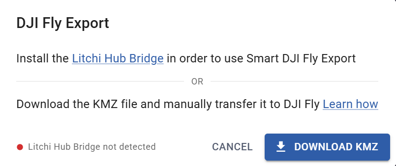

B. Manual Export Alternative
  1. Click Download KMZ in the DJI Fly Export popup
  2. Locate and replace the DJI Fly KMZ File
  • Using a file explorer, connect your device in File Transfer USB mode and go to:
Android: Android/data/dji.go.v5/files/waypoint
iOS:     DJI Fly/wayline_mission
  • Locate the latest folder that was created in the above location, then inside you will find the KMZ file created by DJI Fly.
  • Rename the KMZ file exported by Litchi Hub to the same name as the KMZ created by DJI Fly. Then replace the DJI KMZ with the Litchi Hub KMZ

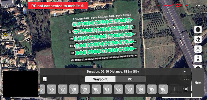

If you now go back to the DJI Fly app, you will be able to load the flight planned in Litchi Hub!
For iPhone/iPad users, if you created a new flight, make sure to restart DJI Fly to see the new flight.

I downloaded a kmz file from hub 2.0 and used this technique to run a waypoint mission on my Air 3s. It flew a straight line mission without the usual rounding added by DJI. The drone also stopped at each waypoint. Is this the expected behavior?
I have previously used this technique with kmz files produced by Litchi mission utilities and a Hub 1.0 csv file. Those waypoint missions had the typical DJI rounding.
It is if your path mode is set to straight lines. If you sent the path mode to “Smooth Curves”, you should get your expected behavior:
Capture
Thanks for the quick reply! I did have “path mode” set to “straight” because when I set the path mode to “curved turns”, the export dialogue replied “kmz export does not support curved turns flight mode”. I had set the “drone model” to “other” and “Smooth Curves” was not an option so I used curved turns. When I set “drone model” to Air 3S, the “smooth curves” option was available. I was then able to download the kmz file!
What is the difference between smooth and curved turns?
By the way, the “straight lines” option eliminated the danger of the drone descending lower than the waypoint!
You should see the difference when selecting between the two with an appropriate drone model. “Curved” is used by the Litchi engine where “Smooth” is used by the DJI engine.
I have encountered the same problem. Since I use DJI fly I have to export to kmz but it does not allow me to export the routes with “curves” at the waypoints, but only those with “soft curves” or “straight lines”. However, with the old cvs to kmz conversion system it accepted the “curves” at the waypoints and even in DJI fly you could see the track with the curves. Soft curves are difficult to control because the route can drop too much in altitude or widen too much where it shouldn’t.
You will need to explain what you mean by “soft curves” as that term is not used by either Litchi or DJI.
DJI Fly waypoints only support curved paths that pass through each waypoint. As a result, it is possible for the flight path to become lower (or higher) than an adjacent waypoint. It is also possible for DJI Fly to fly a straight line mission. However, such a mission must be loaded via a KMZ file as there is no way to select the path mode from within DJI Fly.
Sorry “Smooth Curves”..
Ok. I understand now. What Litchi is calling “Smooth Curves” is referring to DJI’s method of making the flight path pass through each waypiont. Litchi’s method places a straight flight path between each pair of waypoints with the option to use curves at the locations of the waypoints.
Each method has their advantages and disadvantages. As you point out, DJI’s method may allow the flight path to become lower (or higher) than any of the waypoints used to create the path.
As DJI does not support Litchi’s style of curved flights, one cannot export that kind of path into a DJI KMZ file. Your only choices will be either straight lines or smooth curves.
