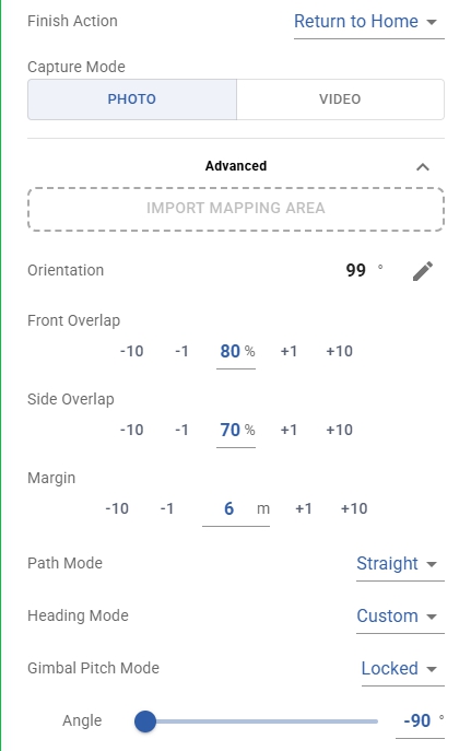

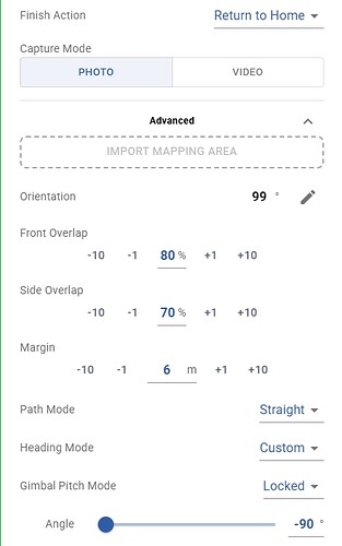

Any update on image overlap? I was looking for this in the new release while planning a mission but was unable to locate it.
Click on the word “Advanced” on the bottom of the settings.
