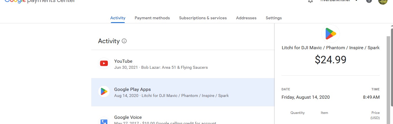

Hello Kaehn, and thanks for these links to payment records that I’ve never encountered before. From the receipt from the Google Play store dating back to 2020, would I be correct in speculating that this Litchi purchase cannot be for an IOS device and therefore must be for an Android device?
If this is the case then I must have bought Litchi versions for BOTH the IOS and the Android platforms, only to forget entirely as the years went by that I also paid for the Android version. I only ever used the IOS version of Litchi on my iPad thus far, so this is the first time I actually looked into the possible existence of a paid copy of the Android version for my devices.

Yes this is an android license of Litchi. You can only download it without paying if you already paid for it.
