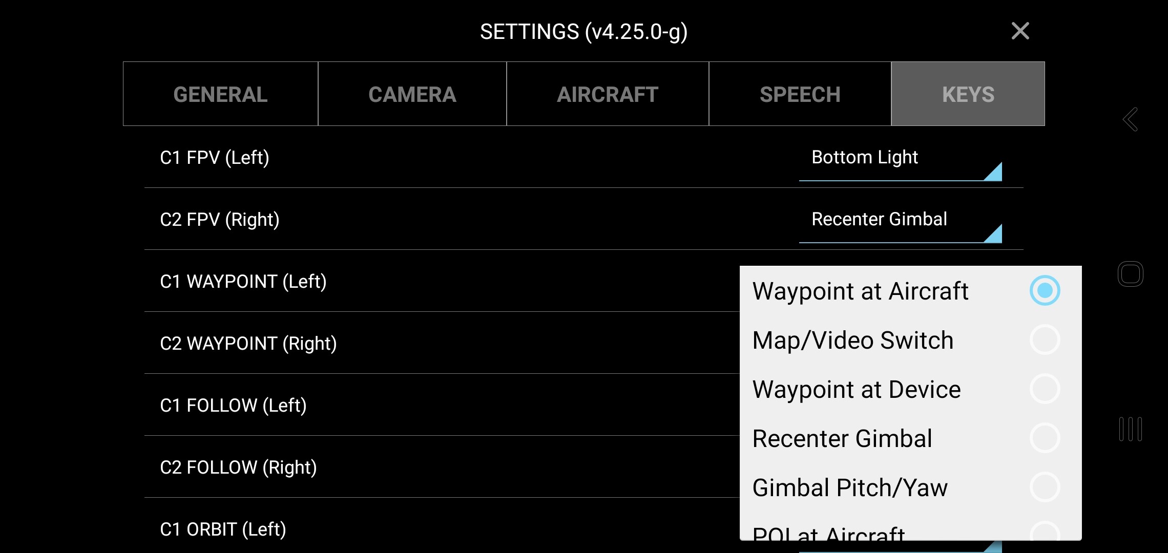

Or the reverse method is to fly the drone to the desired point and set the “waypoint in the plane” so you can find out the coordinates and dimensions
where do i find “set the waypoint in the plane”? and will it tell me the size of the area i have flown; i dont want the circumference/length of the flight eg 3km, i want 5acres for example
You need to assign a function button in settings. Last menu
Yes, this way you will know the dimensions between the points

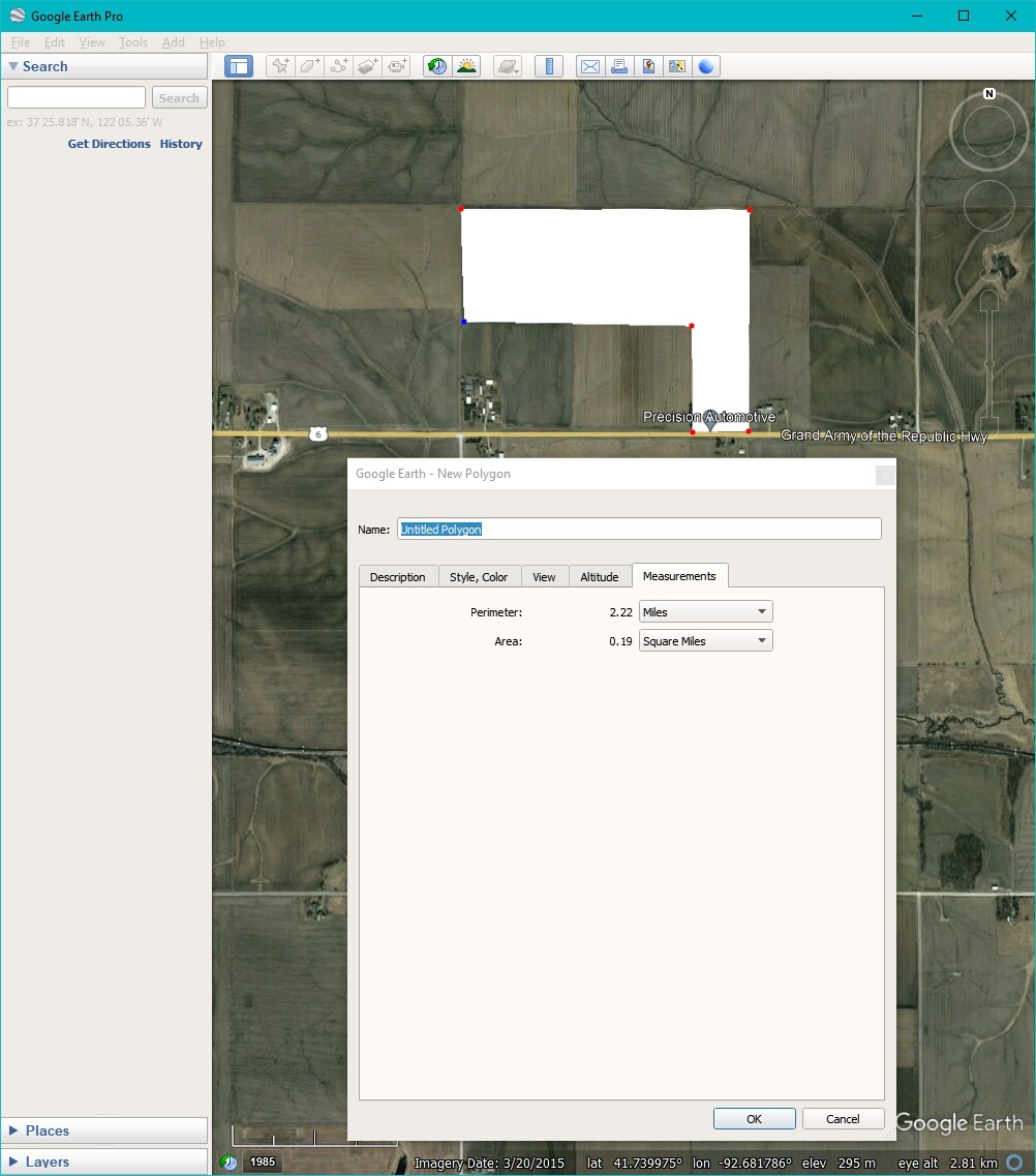

Here’s a simpel way to do so using Google Earth:
  1. Open Google Earth
  2. Zoom in to the paddok
  3. Draw a Polygon around the borders of the paddok, the polygon can have has many points/corners as you want (dubbel-clicking the last point closes the polygon)
  4. Check the ‘Measurements’ Tab

If the paddock has been there for more than a couple of years then go onto Google Earth, draw a polygon around the paddock and then you can read the area in acres or hectares.
