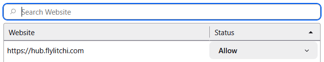

In Firefox, go to settings, Privacy & Security, scroll down to Permissions→Location and click on “Settings”. Check to see if hub.flylitchi.com is allowed.
Hi Wes, The more i search, the more i find that this seems to be a recurring problem with Win 11. Just to refresh, I’ve done all the tweaks that are recommended, resetting my default location etc (although it seems that Microsoft has turned off Maps) Turning geolocation off and on, making sure i have no proxys or VPNs running. So….It seems that my location is somehow embedded deep in the system. My Mac laptop and my Android phone both have the correct location so i think it’s not a problem of my ISP location. Oddly enough. Google maps has it correct but Google Earth still has it wrong. I need to do some mapped flights over my property so i guess i just have to move the map to my home location before i plan the flights. It looks like there is no way round the problem but i’m always open to suggestions!
