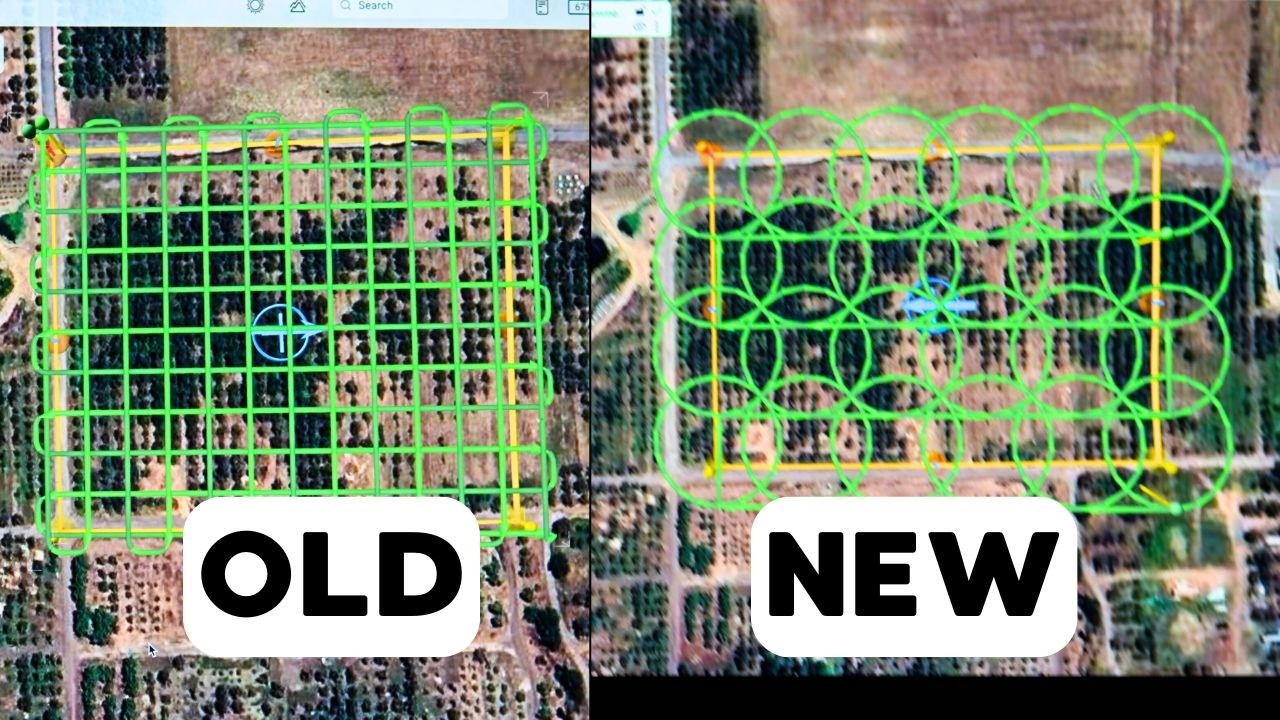

is this for otho / 3d model creation, if so, then yes I have been looking at that and thinking about how to best do that.
I have also stumbled across another way of doing otho photogrammetry using circles and trying to figure out if there is a way to integrate this arrangement too.
