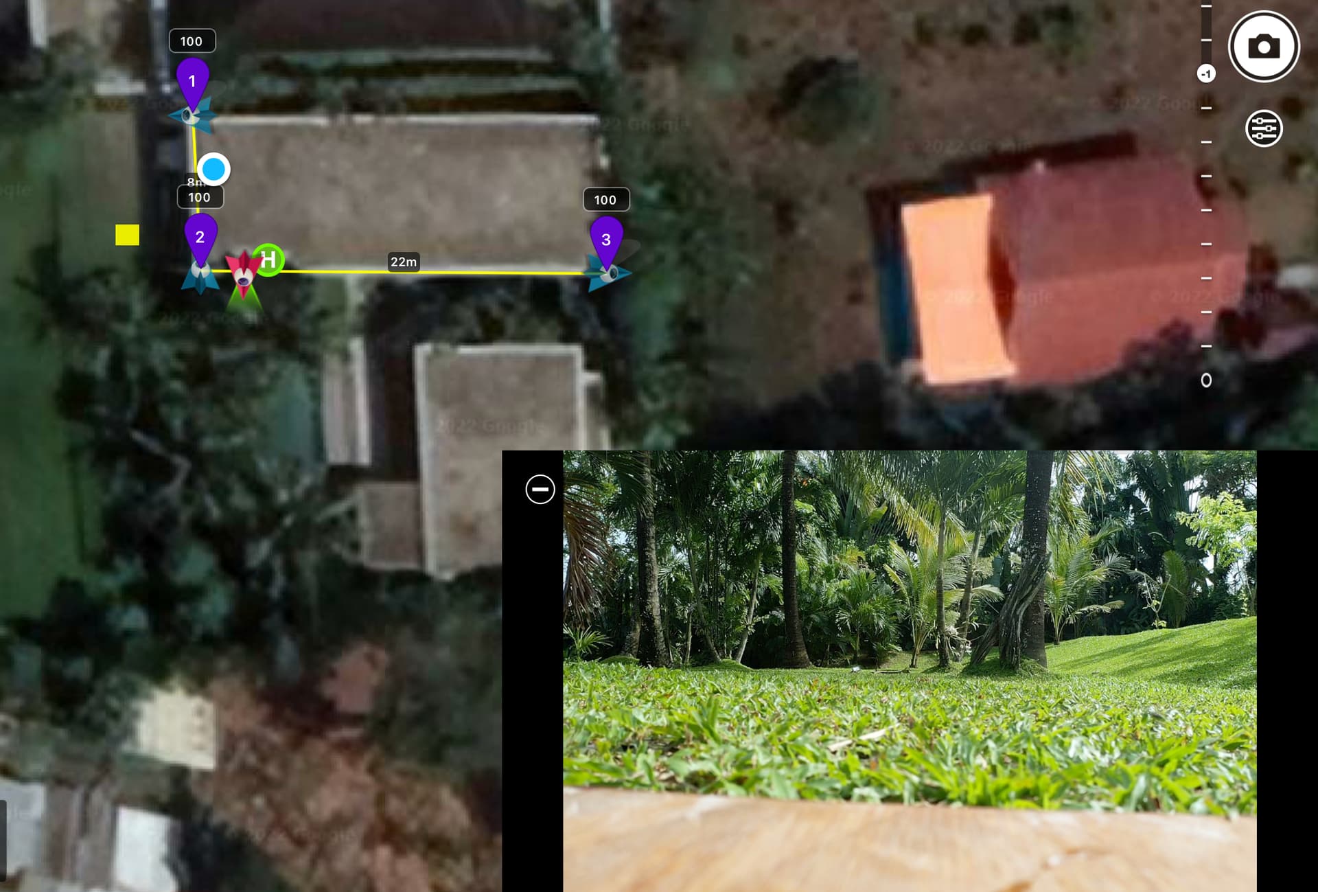

The flights I need to do require quite precise positioning between high rise buildings to simulate views from different units. The problem I am having is that the drone GPS is showing quite far off on google maps. Strangely in the DJI Go 4 app it is almost dead on.
I realise that I could move the flight path around but this seems a sloppy way to do it and not easily repeatible. Any suggestions on how to deal with this.
Yellow square in the image is the actual drone position.
I should add that this is a consistent error which shows up on every startup to roughly the same amount and direction

I have repeatedly checked that all the mission points are shifted in one direction by several meters.
Whereas my phone shows me on the map very accurately.

You are mistaken, there is no effect, because the position of the smartphone is very accurately displayed on the map and on the ground and on the roof of a tall building. I build routes when I am at a location and put points exactly according to the position of the phone on the map.
If I have a route in the field and an altitude of 100 meters or more, I certainly do not need such accuracy. And that wasn’t always the case, I had routes with 1 meter accuracy before and it was excellent.
The author of this topic correctly says that if at the moment the drone is turned on, when the smartphone and drone icon is displayed on the map, at that moment you need the opportunity to combine these points - this will be the gps calibration
