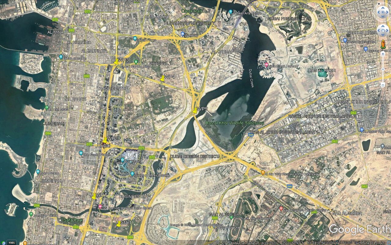

Hello, if I export my flight route from Google Earth Pro as .kml and then import it into Litchi Missionhub, everything is shifted. What am I doing wrong?
I do 1 point as start then WP1 WP2 WP3 … export and then import in Litchi. The route is GPS shifted.
I have attached 2 screenshots. You can see it clearly there. When I import the WP from Google Earth into Litchi, they are in a different location in Litchi

When you import the KML, do not check ‘Treat views as waypoints’ then it should work fine. I just tested it myself and no shifting issues from GE Pro to Mission Hub
J’ai déjà eu ce problème, c’est une mise à jour de Google Maps qui n’a pas encore été effectuée sur Litchi hub, donc il faut patienter ça va se faire
Thank you. It Run verry good now
