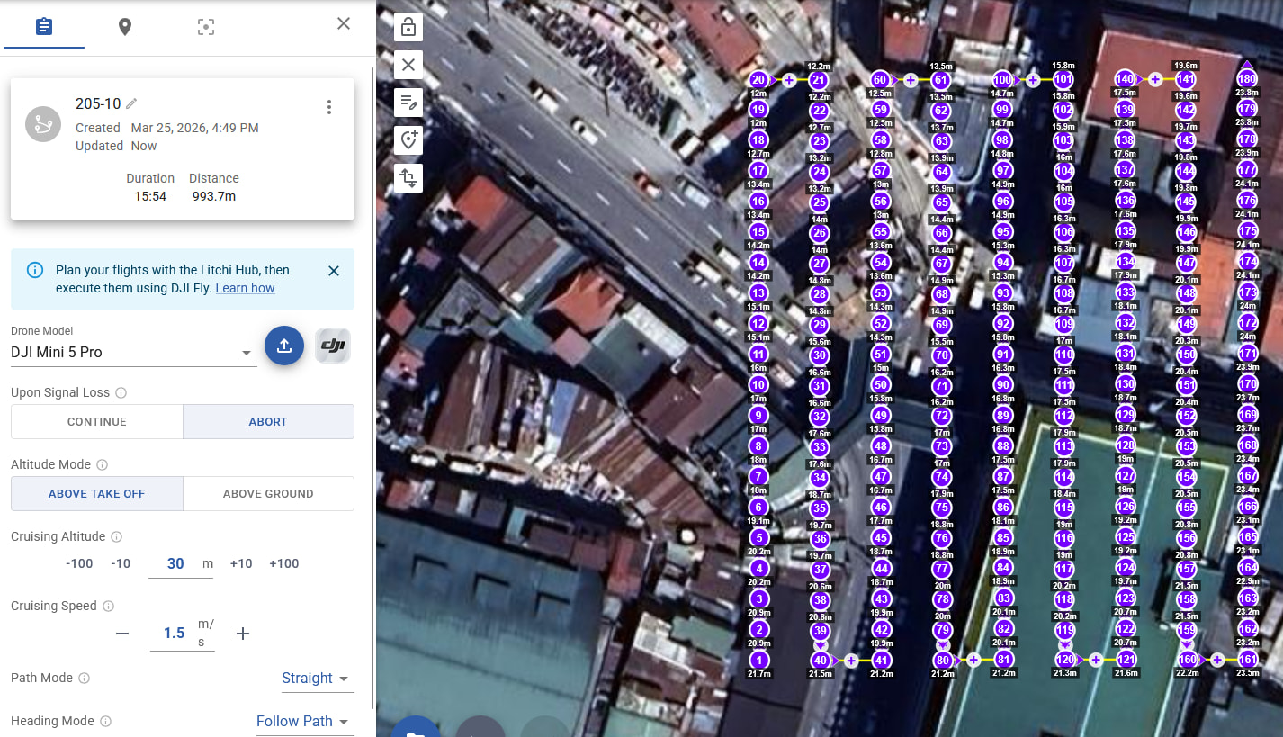

So below the screenshot of the mission. I can’t adjust the individual waypoints, and I don’t actually see their elevation above take-off.
So the steps I’m doing below, to get to the screen I see at the bottom - I wish this were available on the mission hub from the start, so I don’t have to go through all the steps outlined here (closing on mission hub, opening in the android app on the tablet, adjust, save and ctrl-f5 at the mission hub)
Why not allow me to do this from the start without this 3-4 minute work for export/import/export/import between the mission hub and the litchi app. And why I need to switch back and forth between the Mini 5 Pro and the Mavic 2 Pro.. Just let me do this straight away without all the hassle :rofl:

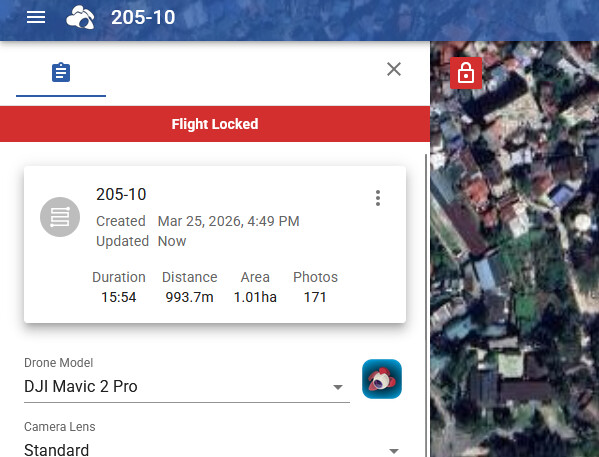

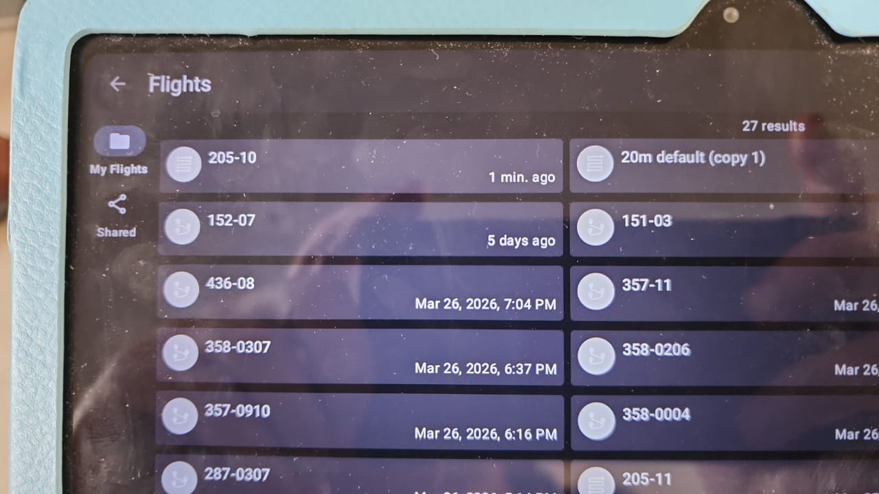

So what I do is, I now load that into the Litchi app on the tablet.
First I need to change it to Mavic 2 Pro - because the Litchi app claims it can’t do this for the Mini (It can so I have no idea why Litchi claims it can’t)

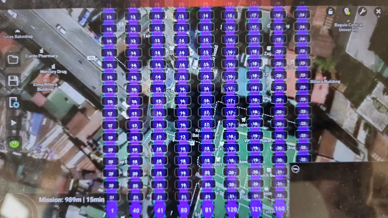

Now I can open it on the tablet

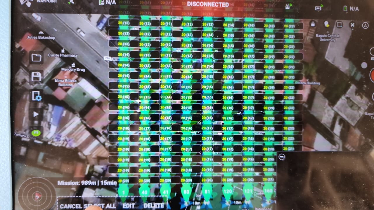

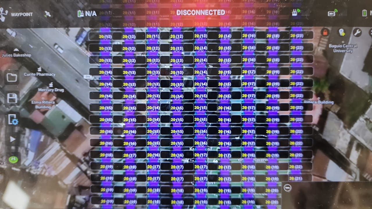

I now unlock the mission - I see here ATL and AGL (Something the mission hub web interface doesn’t show me)
Select all

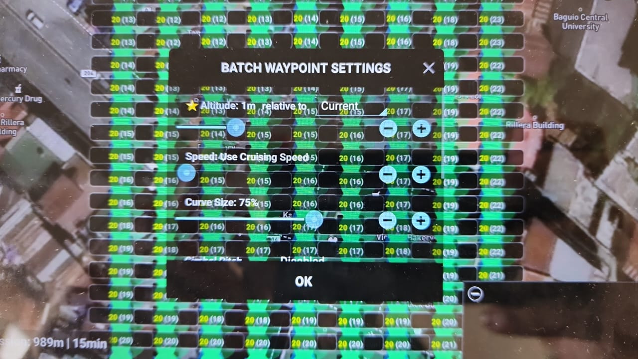

Batch waypoint all - +1m above the current
I now have them all as ATL properly set, to cope for the fact I’m on the rooftop of a government building - and using the terrain elevation model.

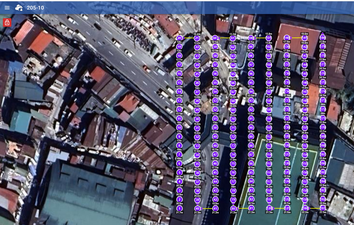

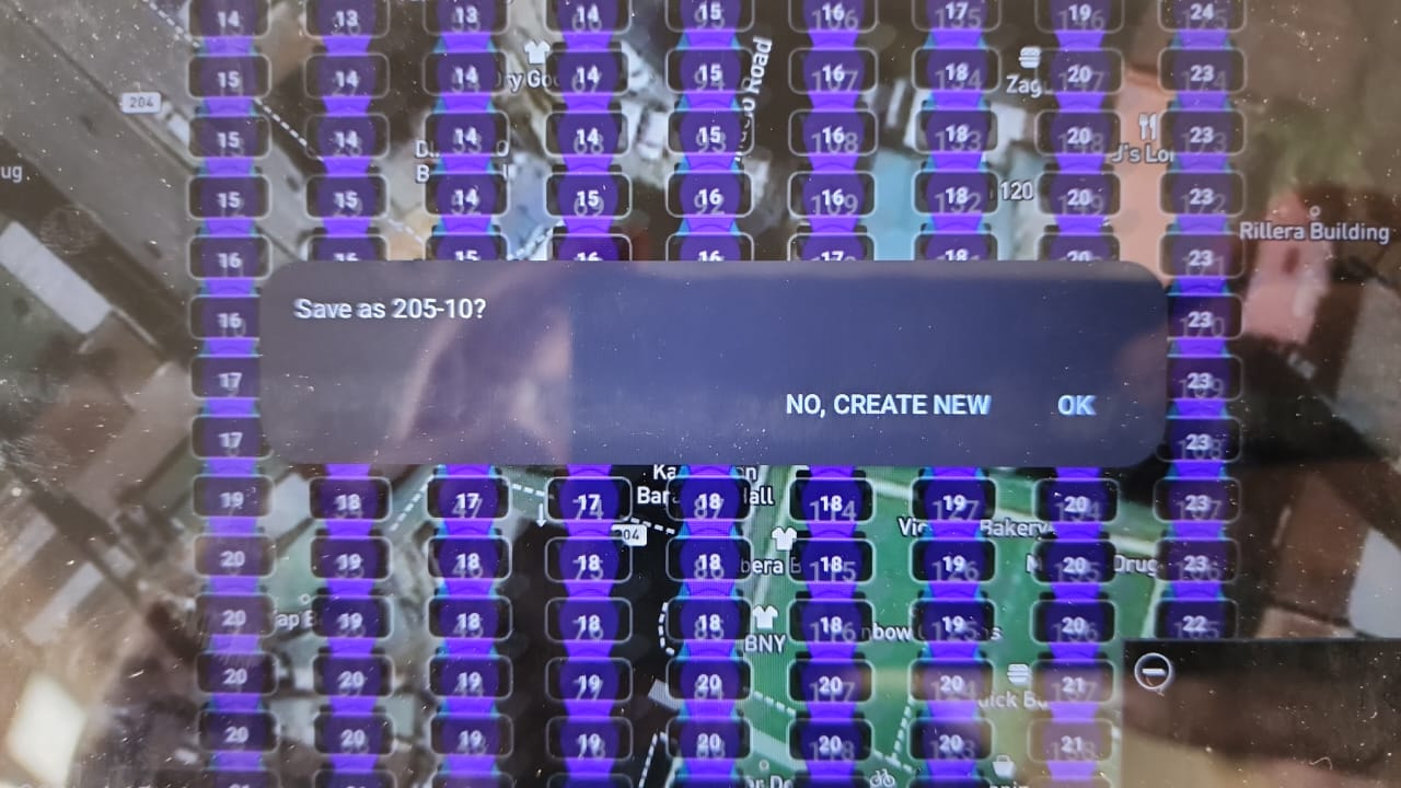

Now I save it back to the Litchi online under my username.
Now I do ctrl-F5 on the litchi mission planner, et voila this is what I want to have on the mission planner web interface, but for some reason the Litchi devs claim I don’t want this to be available on the mission planner (Well I do!)

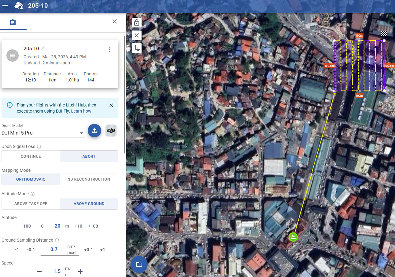

Now I set back the Drone model to Mini 5 pro - and look at the top, the individual waypoints are now available to me to edit them.

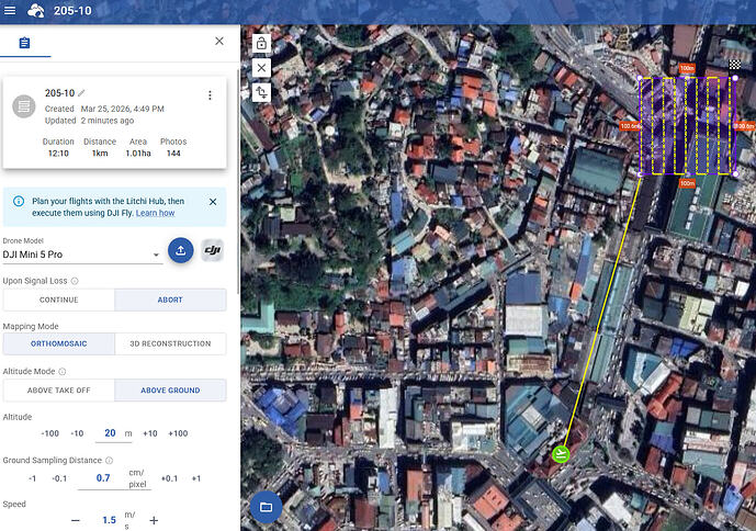

  1. We don’t show waypoints in mapping area mode simply because it would cause performance issues, not to mention the map clutter. You can visualize the entire flight’s elevation in 3D or google earth view mode
  2. You can’t open a flight planned for newer drone models in the old app because they use a new format with much more data in it that the old app can’t load
  3. You can probably do what you want in Litchi Hub directly. For example try exporting your flight to KMZ then importing it back, it will import as a waypoint flight. Then use Multi Edit, select all, +1m altitude
