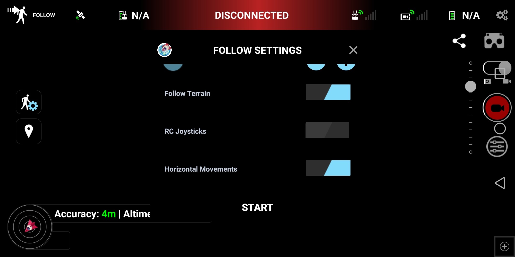

Hi Guys
Doesn’t seem all that accurate, when I set a maximum height.
any idea why not?
When ‘Follow Terrain’ is active, the aircraft will fly at the altitude set relative to the mobile device elevation.
So it all depends on the existence and accuracy of the barometric pressure sensor in your connected mobile device.
Both GPS Accuracy and Altimeter (Height) of the mobile device are dispayed.
In the screenshot below the mobile device “thinks” it’s 10.4 meters below the aircraft.
