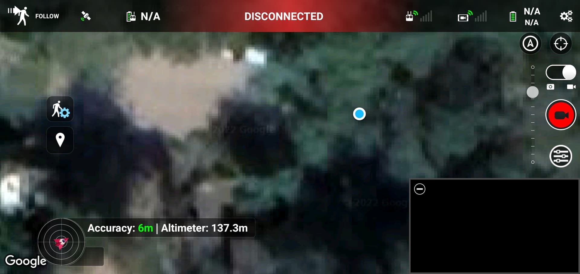

Hi there,
I’ve recently purchased the Litchi Fly app. Awesome software. The follow mode is not working for me however. When the mode is selected, the GPS accuracy of the phone shows in green (like 4m or so) and then jumps to > 1.200m! I do have location turned on, also location improvements (bluetooth, wifi, whatever that may do out in the woods). The thing is: the dot of the location is correct, only the accuracy is said to be so low (huge radius). But, the dot stays in the same location, so even though it might be inaccurate according to the Litchi app, the location is stable.
This is my setup:
DJI Mini 2, Litchi SETTINGS (v4.25.00g) (latest app from the Android Store), Samsung Galaxy S10.
There is no difference in behavior whether I’ve closed all background apps before starting Litchi, or whether running Google Maps in the background. When Google maps is ran in the background and switched to, it has an instant fix of the location.
I’ve already turned the phone up side down from what I am used to to have the GPS antenna face upwards. Which made no difference. Also moving the phone away from the remote controller of the DJI (to decrease possible signal interference) made no difference.
What can I do to resolve this?
Thank you kindly.

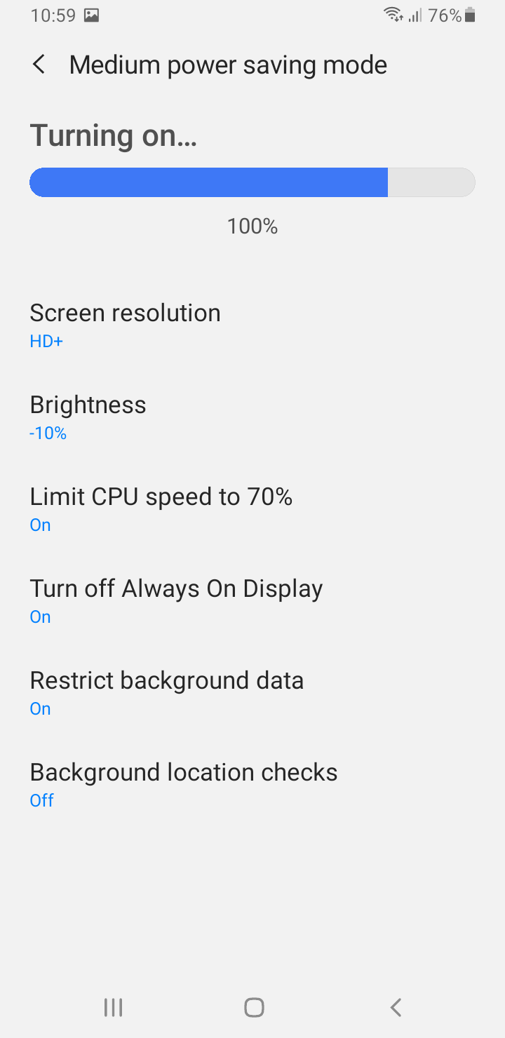

Turn OFF Power saving mode on your phone to allow location checks in the background:
Thank you for your reply. Power saver is turned off. However, following your hint I’ve been reading up. Android 10 had a “Allow all the time” option for Location permissions available in the dialog popping up from the app itself. Since Android 11 this has changed. Now the user needs to manually go to these settings. I do see some apps int he “Allow all the time”, but Litchi is in the section “Allow only while in use”. The Litchi app is in use, of course, when I’m flying. So semantically I do not see a difference. But I will let you know if it does make a difference if Litchi is in the “Allow all the time” section. Now I have to figure out how to get it there…
