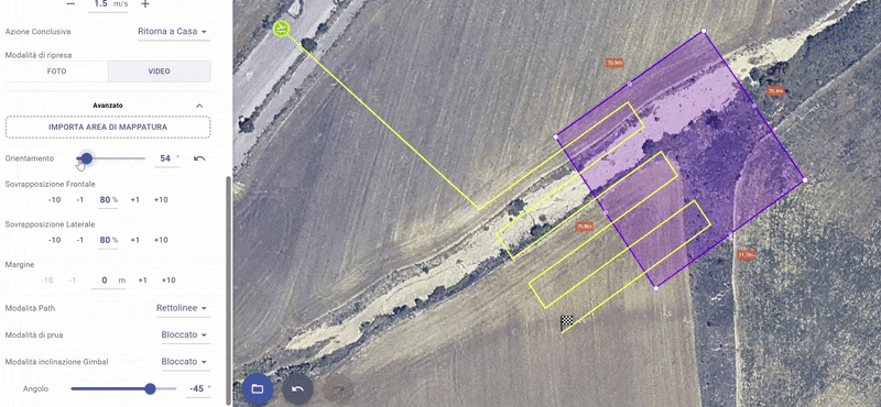

I’m currently testing the new Litchi Hub, and I’ve noticed a strange behavior. When I rotate the path, it seems to have some kind of discontinuity. I can’t rotate it completely to cover all four sides.
I’m trying to manually build four paths for a 3D reconstruction. Video attached.
Litchi_rotation-ezgif.com-optimize

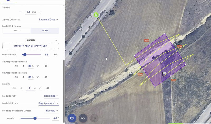

I’ve noticed that if I change the take off point it works, but I don’t think it is the correct way to do that. Thanks.
Registrazione2025-10-22225437-ezgif.com-video-to-gif-converter

This is because you have your gimbal pitch angle set to -45 degrees. Set it to -90 and you should experience the expected behavior. With the gimbal pitch angle set to -45 and a custom heading mode, the flight path will not coincide with the mapping polygon.
Yes, it works with -90, but I actually want to use a -45 or -60 angle. Isn’t that possible? I don’t fully understand why, but I trust your explanation. I know that the flight path will not perfectly match the mapping area, but with the gimbal set to -45°, I can still capture images of the entire area (I will plan also 4 different missions, one for each side of the area).
It’s strange that I can’t rotate the flight plan 360° when using -45 or any angle different from -90. As a workaround, I can change the takeoff point.

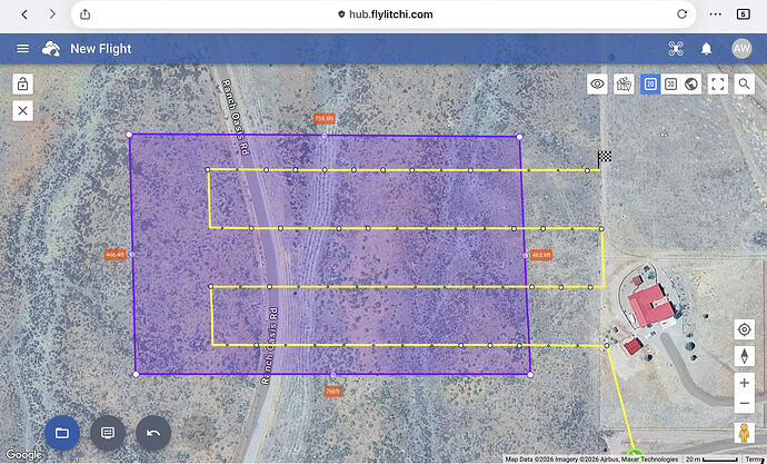

I created a mapping plan and the same issue is still present. I found this thread so you would understand what the issue is. Anything other than -90 gimbal pitch alters the coverage area and path. Not that important for me since I rarely run mapping missions but it may be to others.
When the gimbal is set to an angle other than -90, the path is offset accordingly and this is intended.
I can confirm the bug reported in the first post is fixed after testing again.
Ok. Strange don’t have this issue with another app but no biggie. Thanks.
it is a feature not an issue unless I am not understanding what your issue is?
if you enable the camera projection you can see that the coverage remains similar regardless of gimbal angle
Ok. Screen shot shows that when the gimbal pitch is changed the drone doesn’t fly within the boundary area which is where I would want the captures. I just created a quick map and set the pitch set to -60° and you can see it is way out of the mapping area. It is the same as the original first posting with the screen shot.
